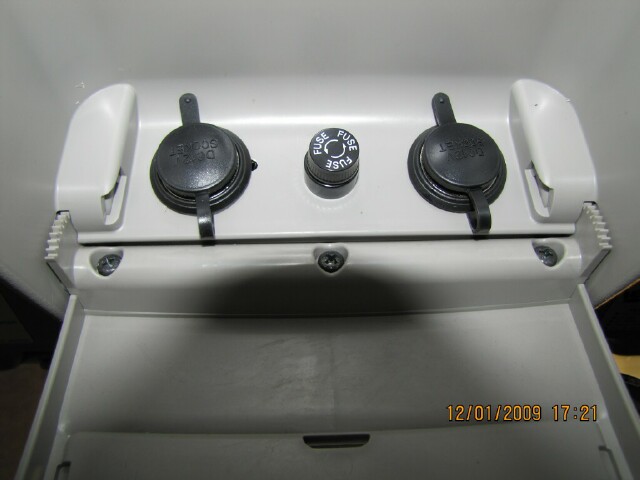

I got a 2008 XD RC2. The first time it failed I had three weeks of Medical leave. I had removed every load in the car. I have modified the original design in that I have power in the headliner box without the key. The first failure took three weeks of non use. There was nothing other than the car consuming juice. This last time. The only load that might of been on was the charger to my GPS. The GPS was not attached. I normally monitor my charge through a DashHawk device. My Charging system is working correctly.
