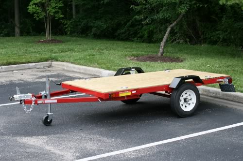

Speaking of trailer hitches... I just bought a new trailer! Harbor Freight had a sale on their 1,720 lb capacity trailer -- after an in-store sale and a 20% off coupon, I got it for about $265!
