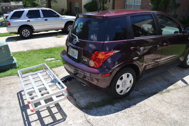

Originally Posted by mcbrew
Just though some of you might like to see the cargo carrier I bought/modified to use with my xD.
I installed the same rack on my xA after seeing yours... I still plan to shorten the square metal tubing so it sits closer to the car (it will be 6" closer to the car than it currently is). Instead of installing it mcbrews way, I just bought a 1 1/4" to 2" adapter. It sits closer to the ground, but I think it will still clear everything I drive over.

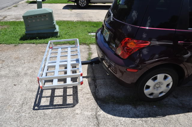

Old Aug 23, 2009 | 11:43 PM
  #106
mcbrew's Avatar
Joined: Nov 2008
Posts: 1,023
From: Annapolis, MD
Looks good... just be careful, because you're creating a long lever arm that is going to multiply the downforce on your hitch.

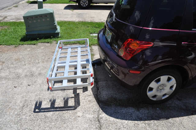

I plan to cut the square tubing which will make the rack sit 6" closer to the car and look like this picture... much closer.
I did stand on the rack as is... the car did sink down in the back, but I didn't dare jump on it. I think it will be much stronger when I shorten it.
Old Aug 24, 2009 | 05:44 PM
  #108
mcbrew's Avatar
Joined: Nov 2008
Posts: 1,023
From: Annapolis, MD
If you want to keep it from sinking down, you might consider a set of Air Lift 1000 bags for the rear springs. I used them in my VW Golf and they worked great. They cost about $70-80 and install pretty easily. You add a few PSI to them when you are towing or have a lot of weight in the back (passengers + luggage, etc.), then let the air out for normal driving. They help keep the car nice and level and avoid bottoming out over bumps.
If you are interested, I have a PDF from the company of all the different sizes. You just measure the ID of the springs and the internal height without a load in the car. Find the closest match and buy that one. IIRC, the rear spring size on my Golf was the same size as the front springs on a Ford Explorer.
Old Aug 24, 2009 | 10:55 PM
  #109
dtpmike's Avatar
Joined: Aug 2008
Posts: 78
I cut the tubing... now it looks just like my edited picture. It feels much better now. Without any weight on it I have about 9" of ground clearance... When I was standing on it (~200lbs.) it had about 6" of ground clearance.
I can't see myself putting 200lbs on it, but if I did I would go very slow over speed bumps and definately not drop off any curbs.
I don't plan on using it very often (mostly on car trips) so I don't think I will buy airbags yet, BUT if fully loaded it hits speed bumps I might be required to get some air bags or raise up the luggage rack somehow.

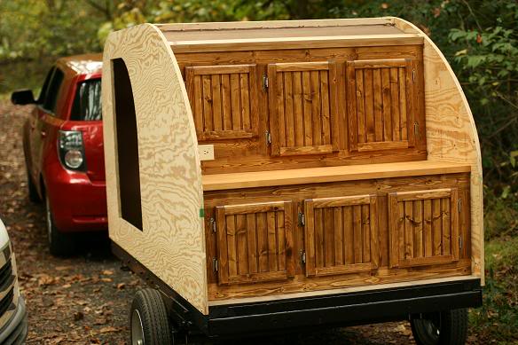

I finally got a free day to work on my teardrop camper... and took it out for a ride down the road.
