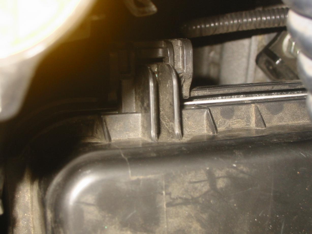

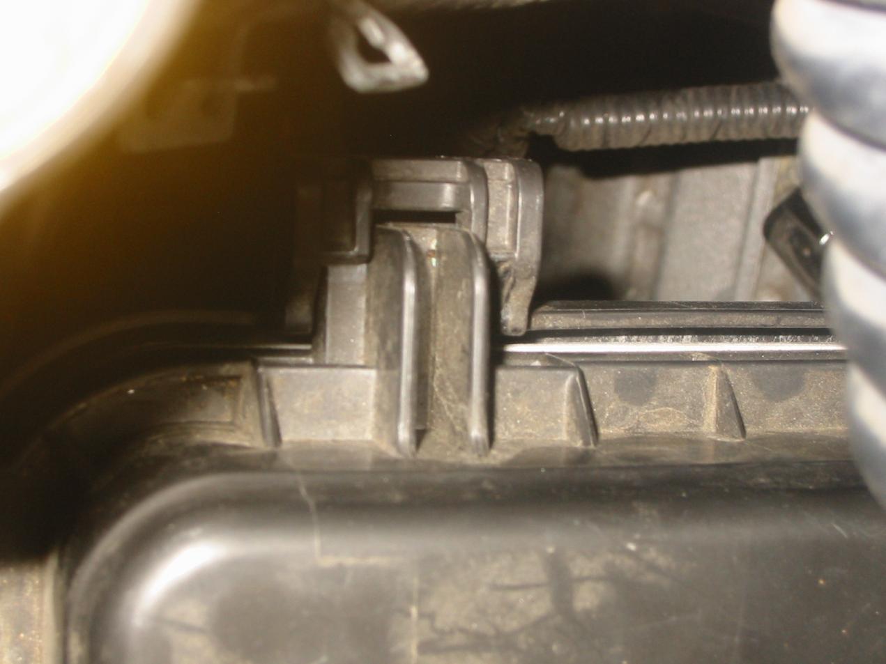

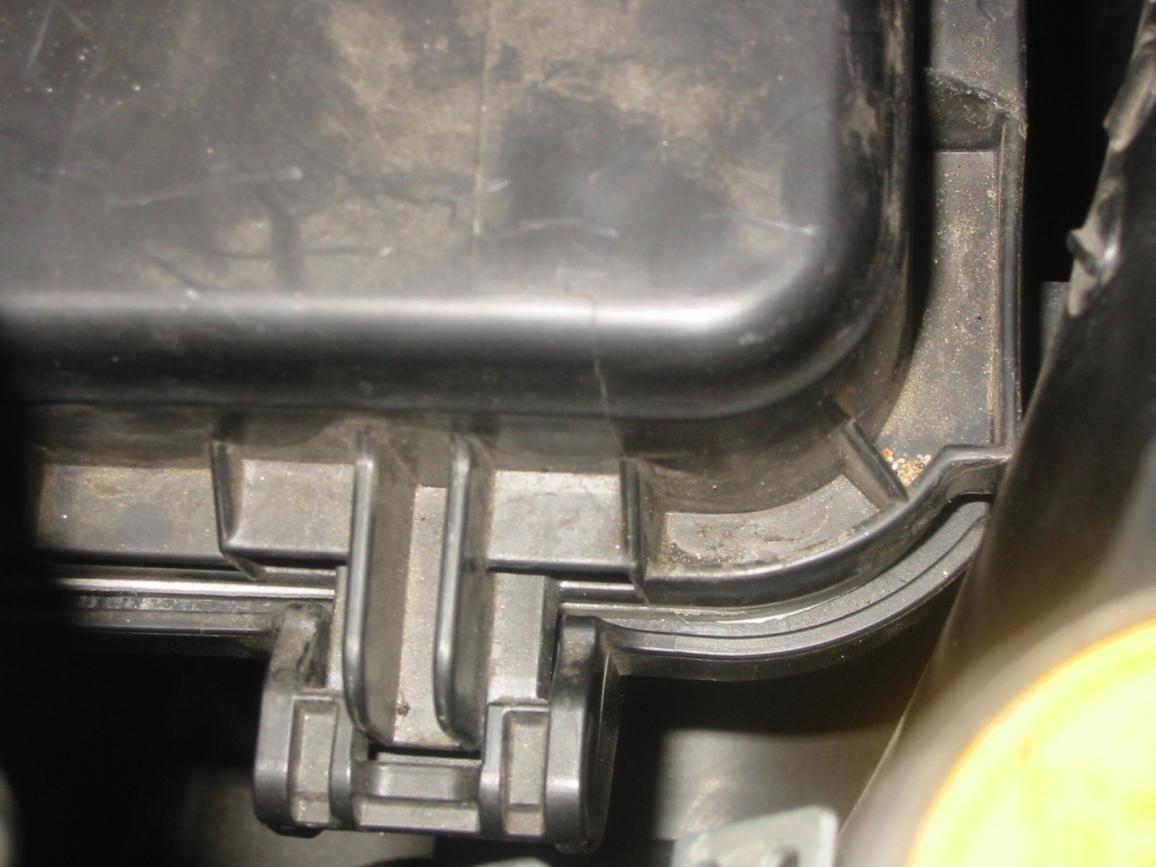

I went to open the hood to install an air filter but there was a gap or seam on the left side of the box and lid? after installing a new filter, i tried every way possible to line up the lid with the box but it is off and not flush.
you can see a little bit of the white rubber filter.
so is this a problem? i have 52,000 miles on the 2009 xd.

Old Jul 18, 2010 | 11:46 PM
viper133's Avatar
Joined: Jul 2010
Posts: 8
sorry for the double post but here are pictures i've taken which shows what im talking about. (i took them kind of slanted and not top view.
Attached Thumbnails Is this normal?-img_0001.jpg   Is this normal?-img_0002.jpg   Is this normal?-img_0003.jpg   Is this normal?-img_0005.jpg   Is this normal?-img_0006.jpg

I think your filter is in either upside down, 180 degrees off or both. If you look closely at the lips that runs the longer edge of the filter you will see two rectangular notches on one side.
