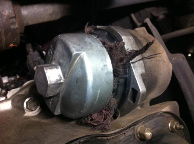

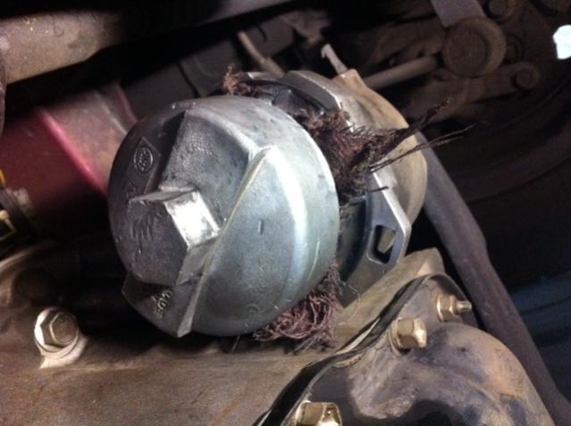

Got my oil changed a couple weeks ago, as I often do, considering I drive 100+ miles a day.
They seemed to be having a difficult time down there - the tech said they had some issues with the filter, and explained that it's a cartridge filter (which I already knew) and blah blah blah - didn't really understand what the issue was, but they assured me it was fine and I was on my way.
Well today my dad happened to be under my car doing a repair, and noticed there was a RAG inside the filter housing. W, T, F. I know they had some difficulty with it, but no one mentioned there was going to be a RAG LEFT IN THERE.
Can someone explain to me what would possess them to do this? I plan on calling them tomorrow, obviously… but I'd just like to know if there is a reasonable explanation for this before I rip them a new a-hole.
See attached pics.
Attached Thumbnails Oil filter housing, WTF-scion1.jpg   Oil filter housing, WTF-scion2.jpg

That's a oil filter removal tool stuck on your actual filter. They didn't have the right size, so they tried to fill the gap between the wrong sized adapter and your filter housing with a rag so it would grip. Its a common trick when you have a worn bolt/nut. Problem is, they didn't take their adapter and rag off when they were done. That's sloppy work from a careless mechanic. You can buy the right size oil filter housing adapter off amazon for 15-20$ and just do it yourself for the cost of the oil and filter. its an odd sized housing, which is why theirs didn't fit it. Hope it wasn't a toyota stealership, cause that would be sad..

Okay so… that part on top is a tool? Not part of the housing?
What exactly do I need to have done here? I am so confused.

Take the tool and the rag off and make sure they didn't murder the actual cap.

Yep, check the condition of the cap and the threads of the actual housing.

Just called the jabroni who is responsible for this; he told me they had difficulty getting the cap off (REALLY????) so they had to use the rag with the wrench; then when he went to get the wrench off it was stuck. He said it won't hurt the vehicle in any way (yeah, until it falls off on the freeway and goes through somebody's windshield). He also said he'd hoped it would loosen by the next time I came in so it would be easier to remove.
He claims the wrench is the right size. Whatever. I told him I'm buying a new cap and wrench today and I'd be by tonight to have them re-do it. I'm going to ask him to pay for the cap, which they've obviously ruined over time by removing it in this fashion.
