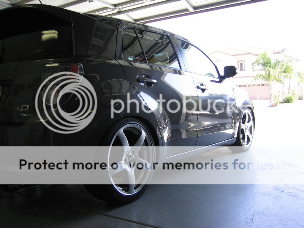

I just finished this up today. Wasn't all the bad really. Did it all on my own. Pretty stoked about the ride. I was on DF 210's and TRD struts, and the ride was a little on the rough side. The Ksports ride very nice! Thanks to Pumpkin for all the setup details.
I will post up some pictures later today.
Hey Bob0Box....whats up brother! That pic was from my phone, not sure how much you could make out. I will email you some of the pics.
Old Mar 30, 2009 | 12:12 AM
cuball's Avatar
Posts: 169

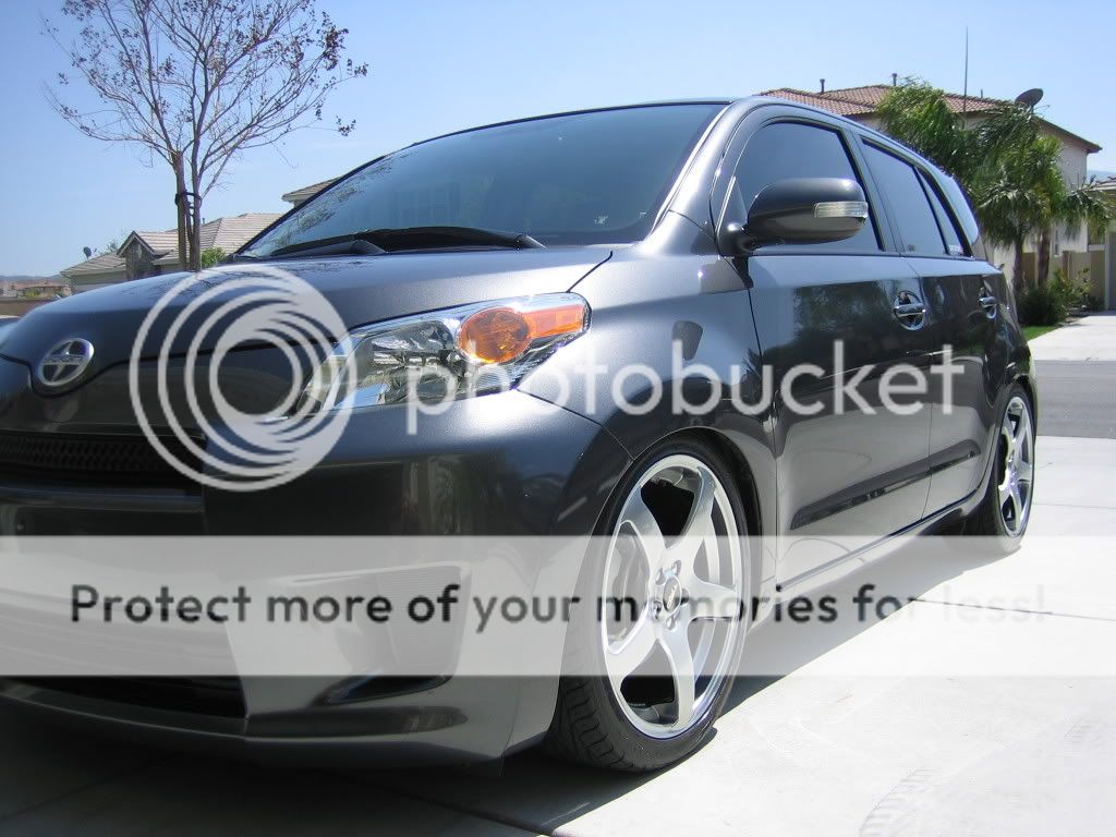

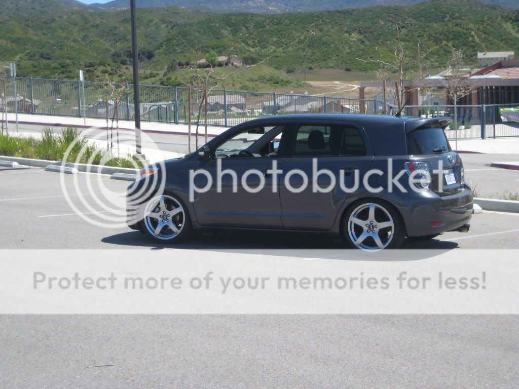

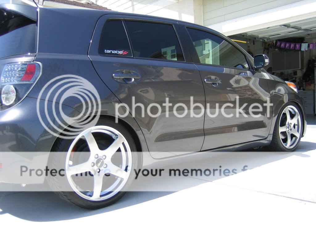

Here they are. I know...the Tanabe sticker is coming off. I had to email Ksports for stickers, they didn't come with the coilovers believe it or not. I think I'm going to adjust the back about another 1/2" lower this week.
Old Mar 31, 2009 | 01:08 AM
cuball's Avatar
Posts: 169
I know this is the best of pictures, but I was focusing on the back after lowering the back another 1/2". I have maybe 1/4" more before the spring perch bottoms out. Oh and BTW, its not the easiest thing to do. Basically you have to disconnect the struts and the swaybar (if you have one) and let the axle drop low enough take the pressure off the spring perch. It just about the same procedure as installation. Kinda of a pain, but at least you have the option. Unless you are on bags...there is no adjustment.

Yea the ride is sweet! A little better than the previous setup. The only problem I'm running into (which I anticipated with it sitting this low) is rubbing up front. I'm getting a little rub on the plastic lining inside the wheel well. I have trimmed it up some, but if I hit a dip in the street with any speed above 20 mph, it drags. So I'm going to try two things. One I'm going to see what 1/4" higher up front will do, and when I take it in for alignment today I'm going t see about a negative camber set to help pull the wheel in just a little.

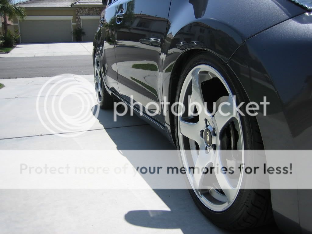

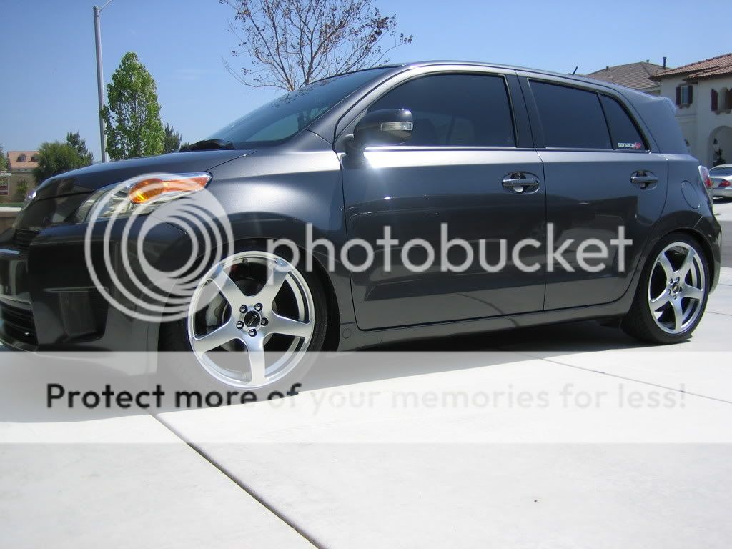

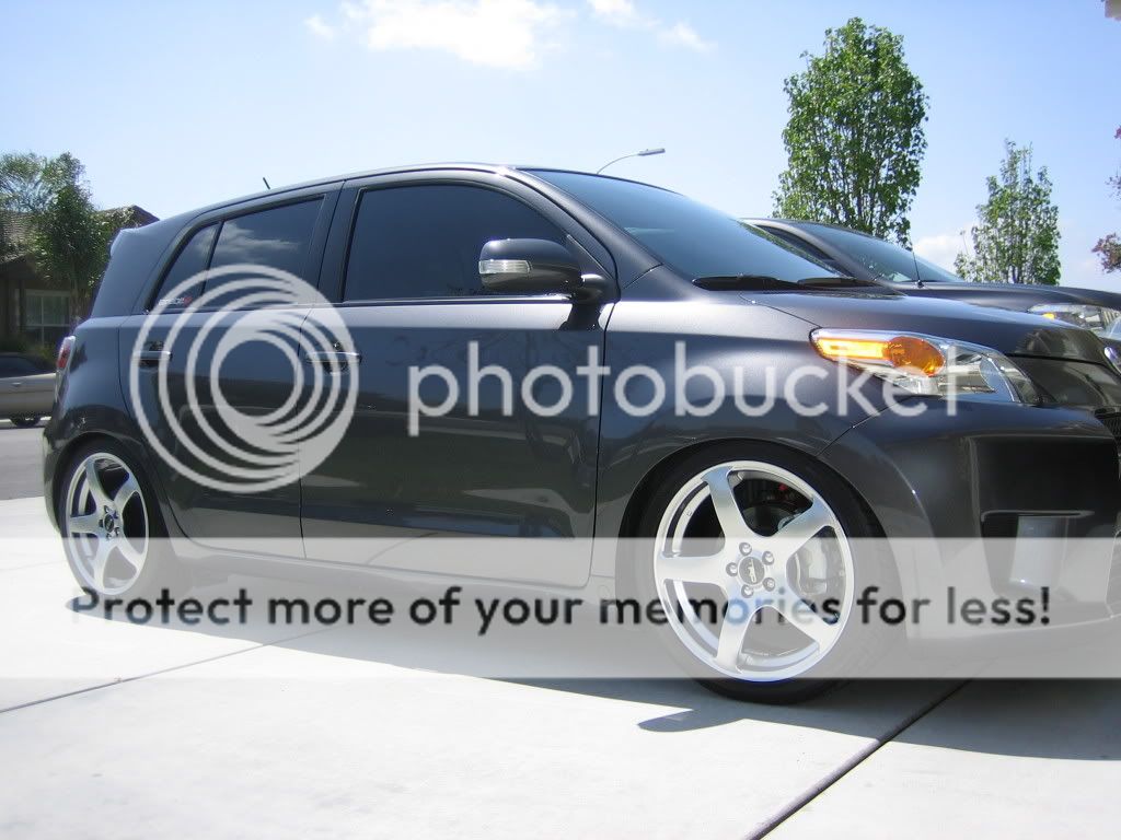

The TRD wheels are 18x7. I think Pumpkin is running a 18x7.5, and he is running a negative camber to get them to tuck in. I'm running very little negative camber and have a little rubbing at times. I also raised mine up another 1/4", it helped a lot with the rubbing. Here are the latest pics.
