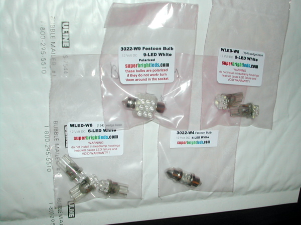

Default Re: Trunk Light
Originally Posted by scionTCny
Does anyone know a light / led to use for the trunk? superbrightleds.com?
The small festoon bulb in this pic is what I used. You will need to bend the metal parts inside the light housing some to make it fit.
