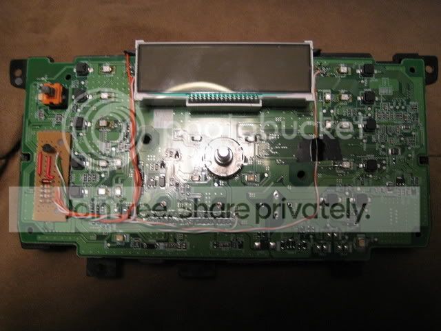

Ok, finally have some together partially and sent the first kit out last night. I did the first mod other than my own last thursday. Now I know you all will hate me.... , but I am travelling to visit family for the holidays, but can resume on tuesday of next week with everything. All work purchased is complete and shipped, so those that are waiting on stuff be ensured it is on the way already, so you wont be left hangning :D
Here is a pic of a kit installed. Not the best pic, but gives the idea of the install process:

I wish it was prettier wiring wise, but running everything that way eliminates the cutting, running wire under the plastic surrounds for the leds (other than the LCD, which has a small gap under the end anyway), etc. Hopefully next week I will be adding something else to that board for another mod as well.
For now, I am finishing up at work and heading on a 9.5 hour drive in a few hours, so Happy Thanksgiving to everyone.
