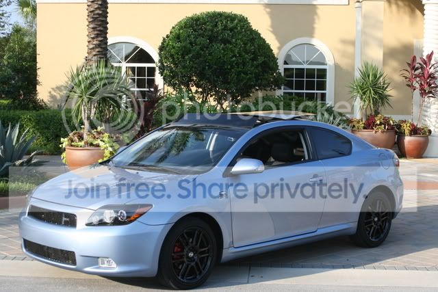

The drop is hotchkis and the springs have about 12k on stock shocks. I think the reason it looks lower is because I am on 225/45/17 tires. No I have never had any rubbing issues what so ever.
Yes in the pics they may "resemble" the spare but, in reality the pics really lightened up the paint color and they are a bit darker.
