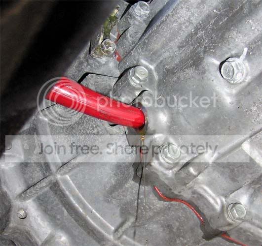

good write up ima sure use this in the future but when u fill the tranny wouldnt fluid be coming out through the "Fill Plug" while ur putting tranny fluid in even tho that is suppose to indicate that its full??
Old Oct 28, 2007 | 04:38 AM
  #229
GammaTNT's Avatar
iTrader: (8)
Posts: 2,592
From: NJ
yes, when u see the fluid coming out of the fill plug, that mean it is full.
i stuck a long funnel to the Fill Plug and adding fluid until i see it over flowing.

This method worked well for me and thanks for the pics...Remember a 15/16 WRENCH for the drain plug. A standard socket will not fit.

i used like a hugeass 24 mm wrench for the drain plug i believe.
the reverse sensor plug on the top where i filled, i didnt have a socket big enough to even go over it. i went to advance and picked up a 1 and 1/16th. worked great.
scratched my arm on the hood latch mechanism when i was tryin to break the bolt loose though.. ah well
