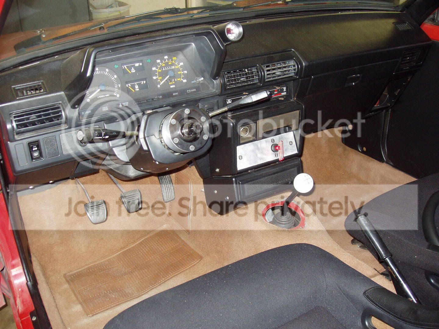

Part 1: Interior Modifications:
Corbeau Forza seats with dual Corbeau 4-point standard harnesses
Autopower cage
Quick disconnet steering wheel
Relocated battery to rear seat with master shutoff near driver
Custom support tray with cover over rear seats & battery

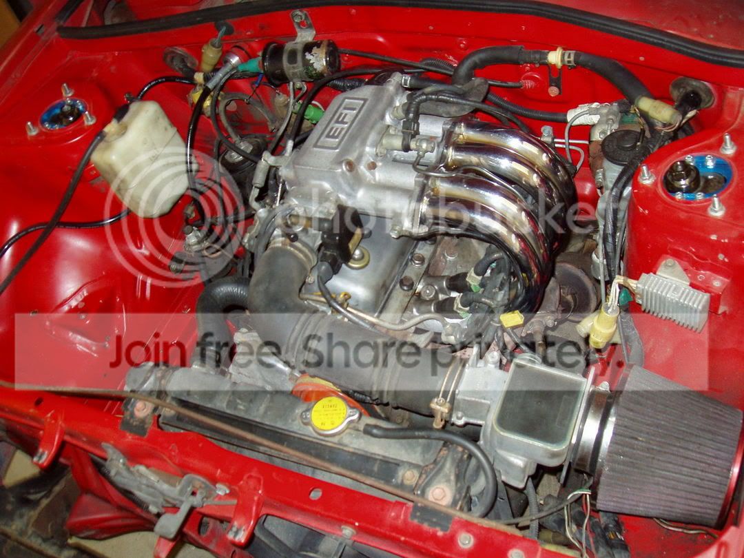

Engine:
4K-E (EFI), 1.3L 4 cyl eng w/ solid lifter conversion. Waiting to install new Kent Camshaft and uprated valve springs.
K&N Intake.

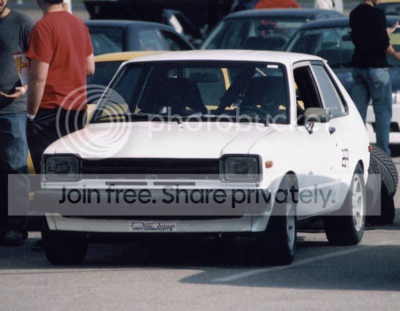

This was my old white Starlet, I owned it back when I was racing in Southern California in Solo II:
The group I pitted with was a Toyota group ... almost 6-7 would race in the Starlets ... we used to joke about it being like a TRD Starlet Cup Car race (TRD junkies know what I'm refering to.

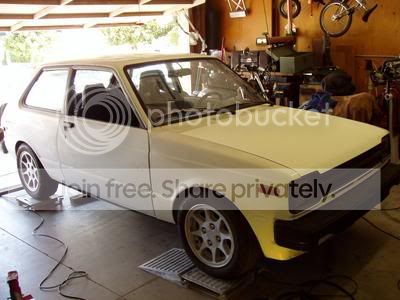

No mods to the new engine (yet).

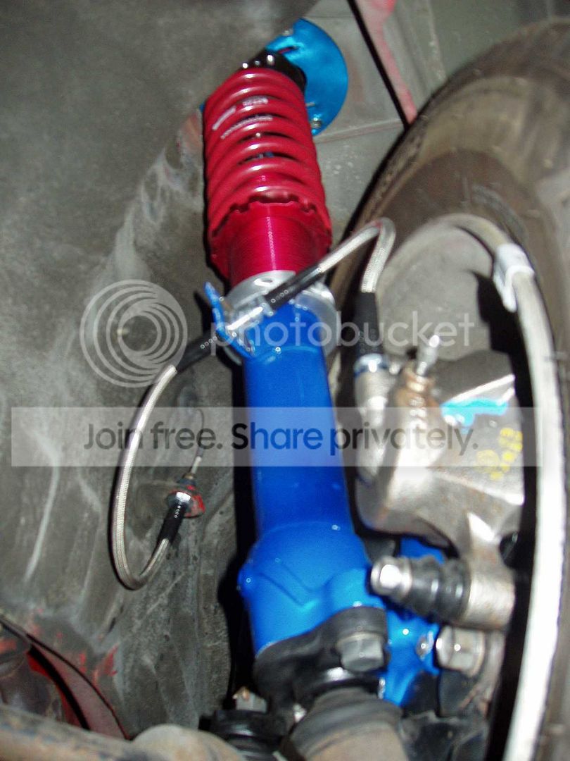

AE86 (Corolla) front brakes, stainless steel brake lines, Corolla strut shortened 2.5" (Thanks Chuck Wade), Cusco camber plates and strut bars (Front and back) from Japan (Thanks Bulletproof Auto in Torrance, CA).

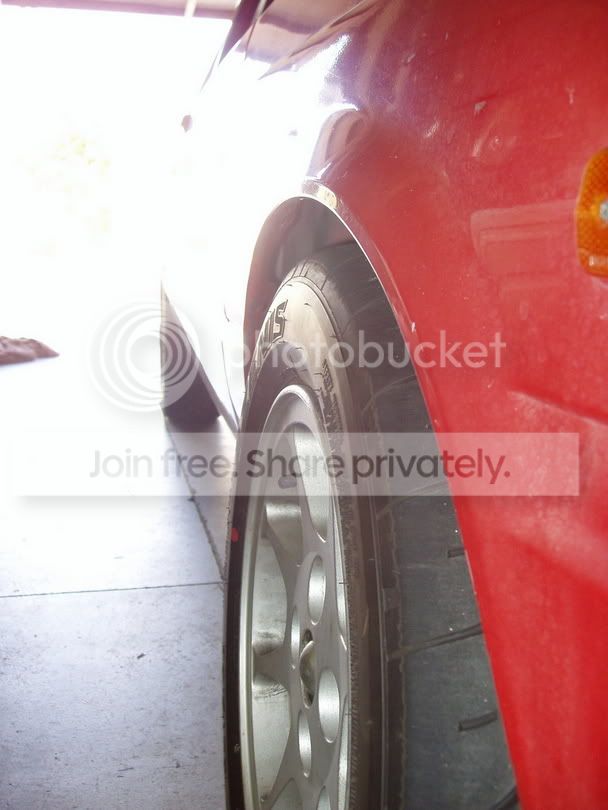

Had to roll the inner fender lip with a baseball bat to gain enough clearance.
Removable wheel, I'm not as young as I used to be (25?) to crawl in and out of the racing seats.

Did I mention I relocated the battery to underneath the rear seat? If you look at the interior shot, you can see the cutoff switch.
