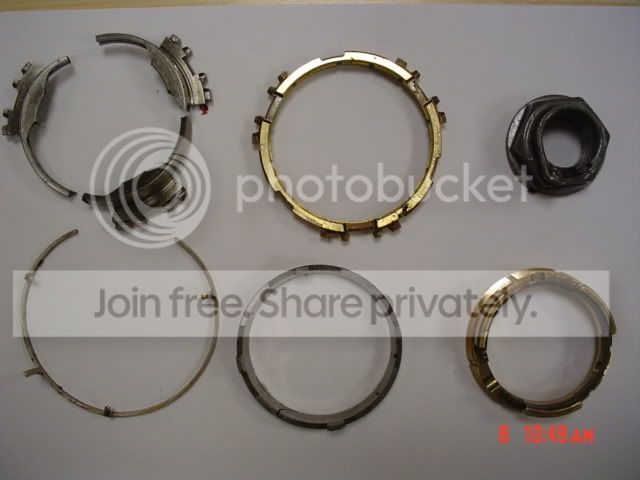

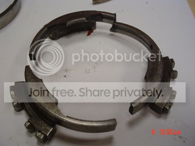

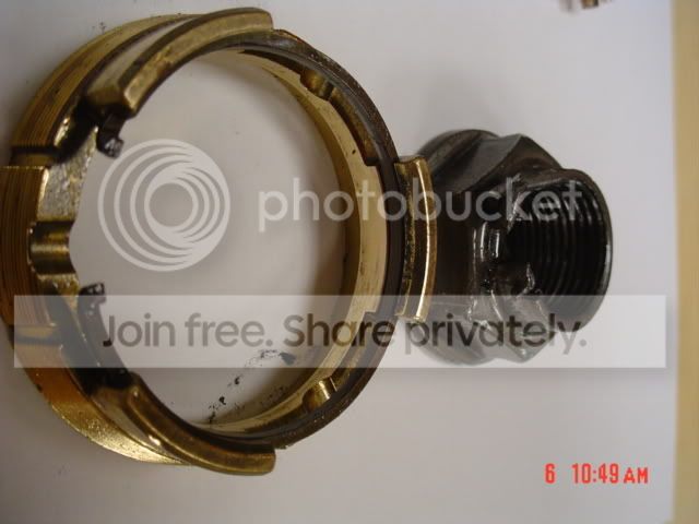

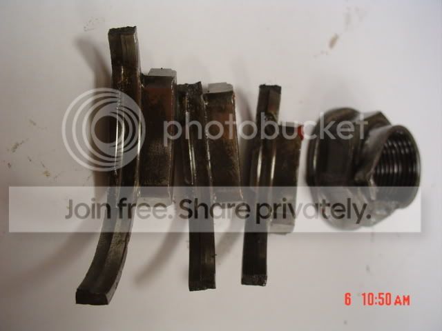

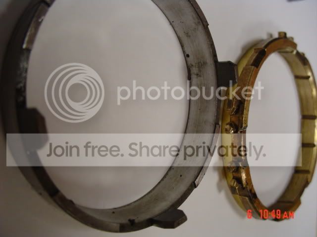

again, reminder, this was 5th gear. toyota said it is impossible to for a tc to harm it's 5th gear synchronizer, ergo, abusive driving cannot harm that part, no tc, makes enough power to break the 5th gear synchronizer.
anyway, i thought i'd upload the pictures of the damaged parts:

Why do you keep ignoring the fact that of course it shifts fine now, the synchro was replaced?????
Have you ever dealt with rings, or plastic, or anytype of clip? If a worn clip is removed it is more prone to crack in the future.
Ptunning did their thing, you could get into gear just fine after they did so, and THEN you couldnt. The synchro or something in 5th gear broke. afer hey reassembled it. You have ZERO proof that it was because of a bad install, UNLESS you can prove it is possible to install wrong. AND you have to prove that if installed wrong it will work for a bit before going.
Synchros go over time ON ALL CARS. Removing them will make this happen sooner. If they had of broken it, or they installed it wrong, it would not have EVER gone into 5th after they had it.
(thats itf they are telling the truth about it only gong one way. Thats what I suggest you research a bit)
