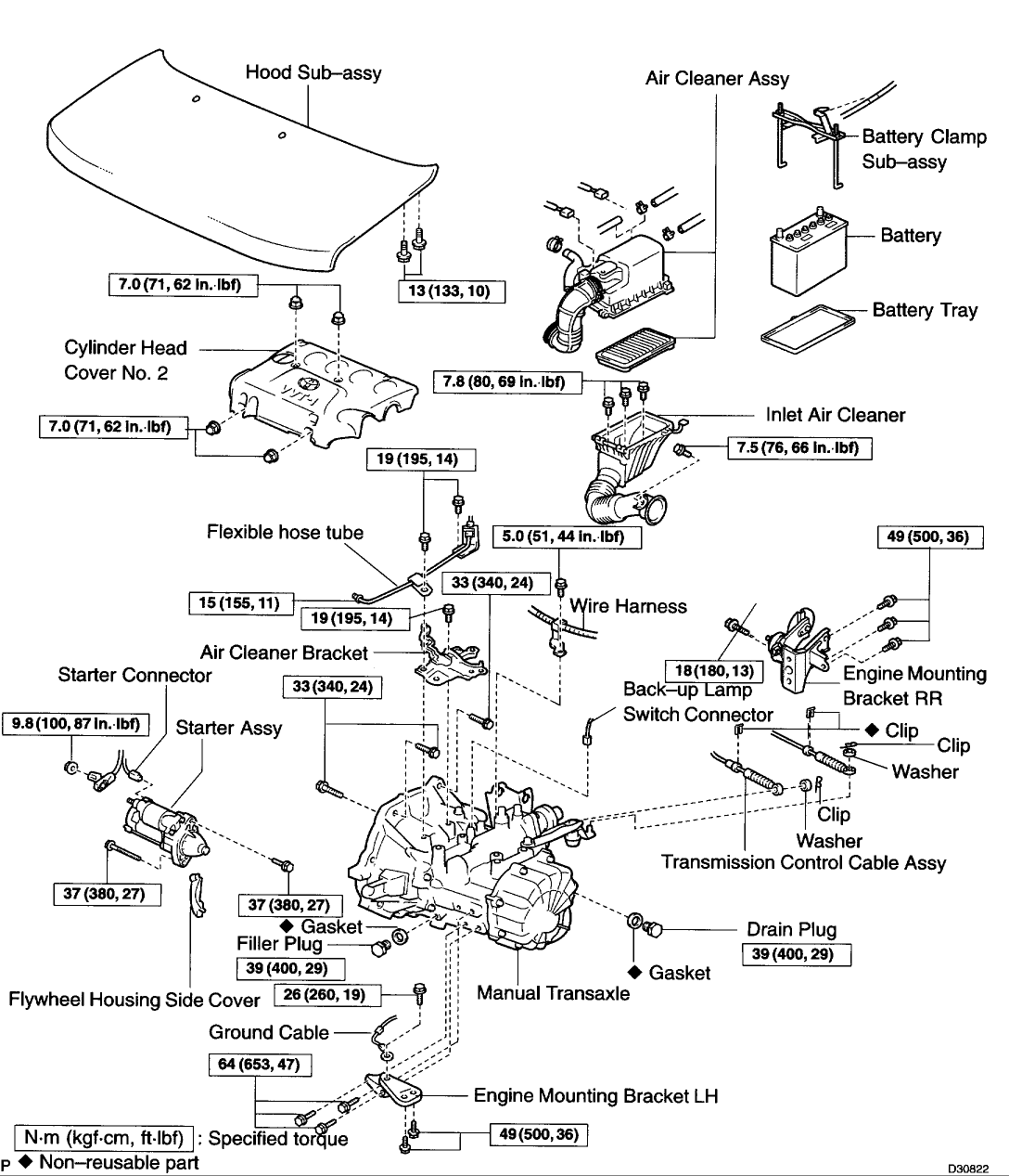

Could someone please let me know where the drain and fill plugs are on a MT XB?

here is an exploded view
