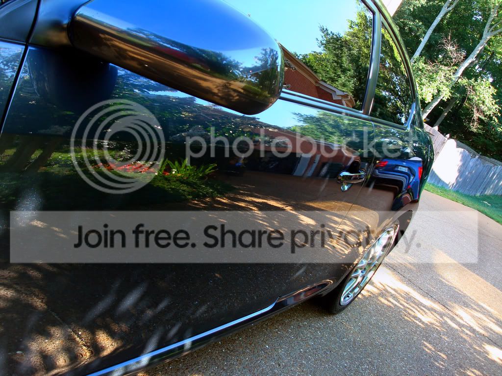

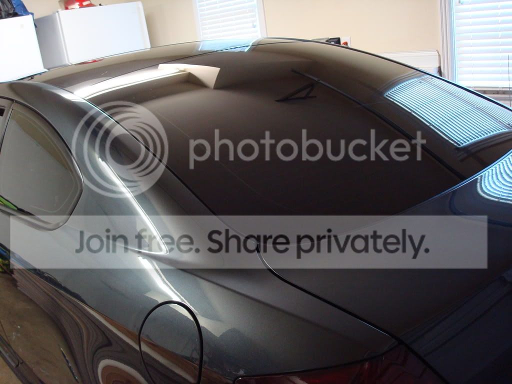

To start it off I'll post my car that I recently detailed. I only did the outside, as the inside wasn't in need of a detail, but not good enough to take pictures of, but next time I do the interior I will for sure take pictures.
Some of the products I used were:
Simple Green Car wash formula
RainX Bug and tar remover(for the front bumper)
Simple Green(All Purpose cleaner- you can use this stuff for anything, buy it)
2 Buckets- one for rinsing, one with soap
Microfiber wash mitts
LOTS of microfiber towels- costco has 36 for under $10 and they are decent quality
California squeegie thing- amazingly easy to dry with
Walmart buffer- I'm working on getting a PC, thats what I used to use at work and what I'd recommend for anything more than a simple wax(polishing, paint correction, etc)
Meguiars NXT 2.0 tech wax
Meguiars Deep Gloss polish(in reverse order- polish then wax obviously)
Groitt's Garage tire shine- love it
Stoner's Invisible Glass window cleaner
I'm sure there is more but I'm exhausted and thats all I can think of right now
Like I said guys, sorry if this is dumb or has been done, or if it isn't helpful. Any questions or comments lmk, thanks
