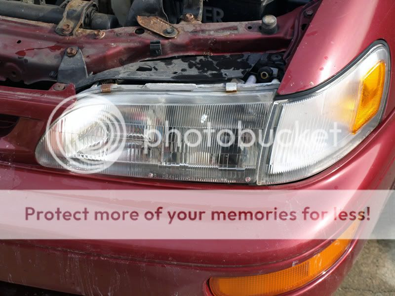

I wet sanded my friend's corolla today.
The thing i used:
800, 1000, and 2500 grit sandpaper
3M rubbing compound
Meguiar's Plastx
and a bucket of water.
here is before.

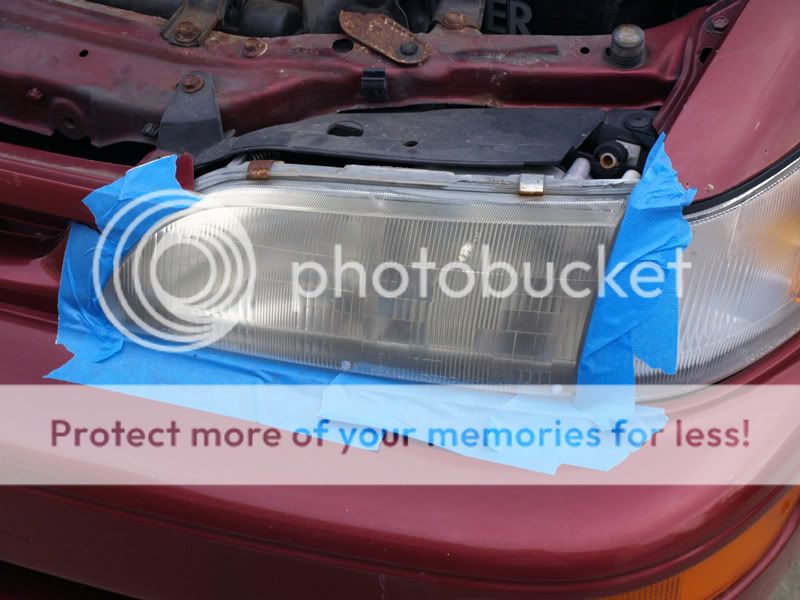

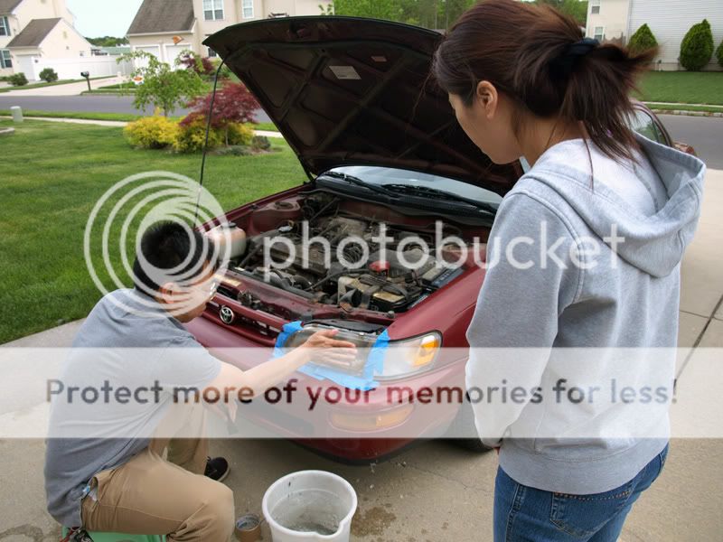

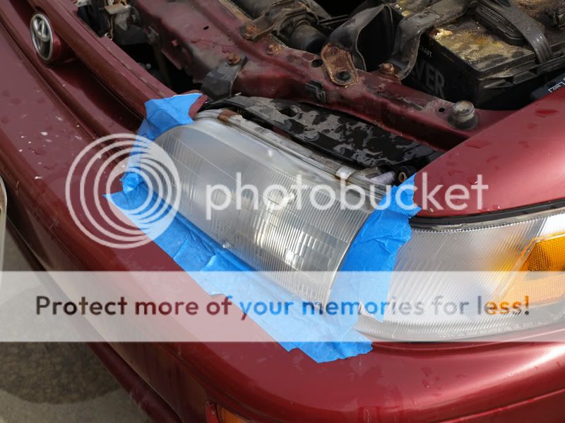

i started with 800 grit, then 1000 grit and 2500 grit sand paper.
I used those sandpaper for about 12 minutes for each grit. Make sure to keep the headlight wet.

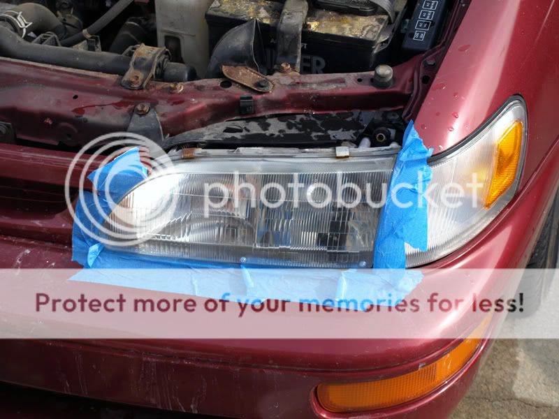

Here is what it looks like after the 2500 grit
and applying 3M's rubbing compound.
i cleaned the headligh with Invisible Glass, and apply Meguiar's Plastx (plastic cleaner and polish)
Here is the finish product.
if you having trouble find those 2500 grit sandpaper, you can use 2000 grit.
I got those 2500 from Crystal View Headlight Restorer Kit($18.50) that i used on my friend's 99 Altima.
Since the sandpaper are reusable, i just ask my friend to buy the Meguiar's Plastx.
These Corolla headlight wasn't as bad as my buddy's Altima. Altima took me about 1hr. and this Corolla took me about 45 minutes.

If you look at the front bumpers from 'before' and 'after'
Those white power are oxidized plastic from the headlight that i sanded off.
