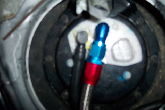

Here are some pics of our fuel system. We are un hooking the regulator in the tank and using a Aero Motive regulator with a gauge not shown in pics I am out of stock. We also made the system a return type. So you will have to run a line to the back of the car and drill a fitting in the fuel pump housing. Here are a few pics. I will have pics of the intercooler piping and turbo by friday or saturday...

Interesting, any idea what effect this will have on the factory evap/purge system?

From: Mooreville NC
It will be fine..Most cars that have a fuel system like this you have to make it a return system..
