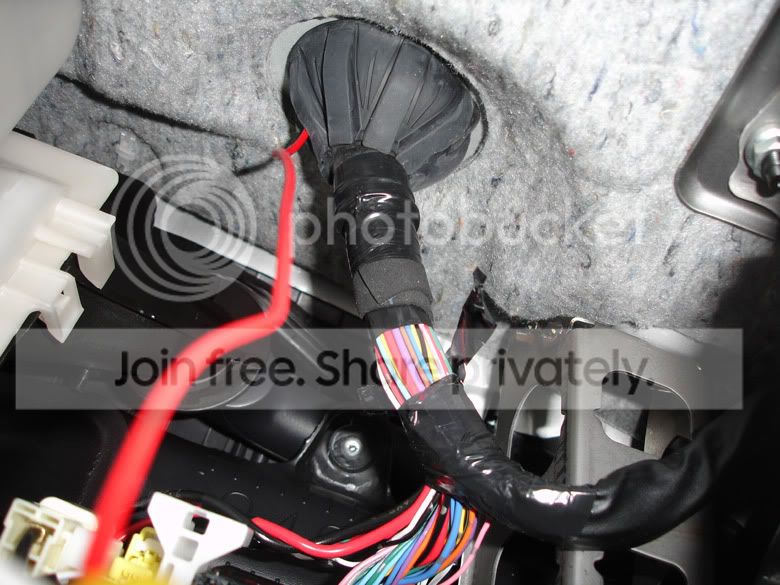

a_german_named_hans's Avatar
Posts: 2,892

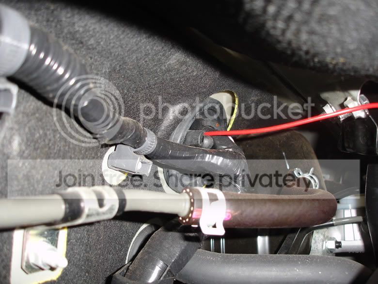

I found it easier to just go through the other way. Take some scissors and cut the little nipple. Then push a wire through from the engine bay in through the nipple into the inside. Could fit quite a few wires through that little thing. I'm running 3 16guage wires and 1 10 gauge wire through that same hole. Heres a picture of mine like a half a year ago. Only one wire goin through it but it clearly shows what were both talking about.
This angle is if you were to look from the Engine block a little to your right on the firewall
This angle is if you were to lay down on the driver side floor and look up underneath the dash.

thank you both for the info. I made sure to test my connections with the switch and everything works fine.
It can be somewhat difficult when you do all this work solo, but it does have a sense of accomplishment to it.
