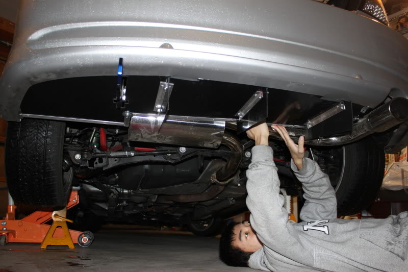

So we got it finished, but not installed. Below are the pics of it in place on the car but not secured, and pics of the top side and underside:

Without:

With:

Thats sweet!!! Who is that under the car?
Old Jan 9, 2011 | 10:39 PM
  #90
Kanchi's Avatar
Posts: 10,661
Allen (allenxtc), our resident n00b!

Thanks guys! Also I have a 5a rear so I will post up when I do mine...it will be a lot easier with a canister exhaust, the TRD one required a lot of cutting of the diffuser...

Also we are having a little trouble finding mounitng points to support the front. Heat shield isn't strong enough and not terribly excited about cutting holes in the floor of the trunk...thoughts?
