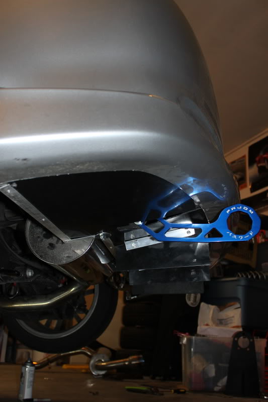

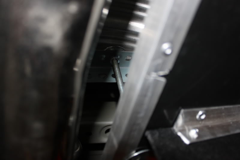

OK, more pics...a lot more. We figured out some bracing and only drilled 1 hole actually "inside" the car.
It looks pretty basic underneath but is strong enough to hold my fat butt! So first pics of the bracing then the finished product.

Passenger side:
Finished product:

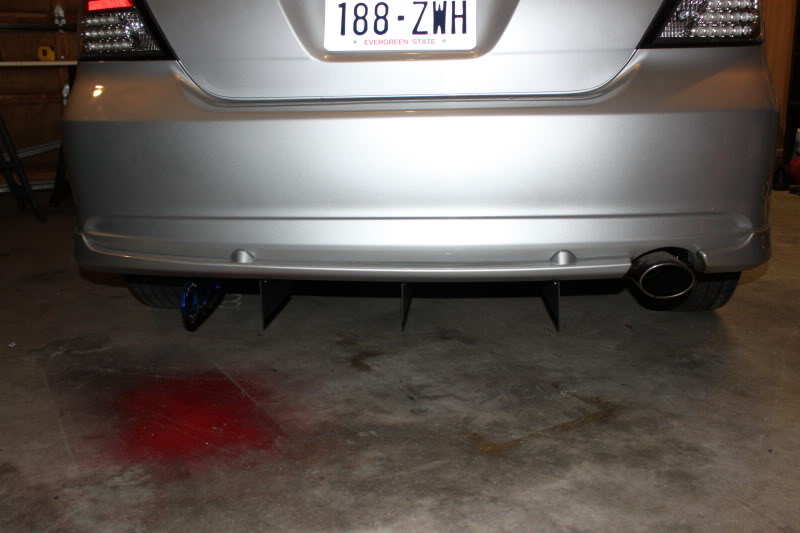

And with the car on the ground:

looks really good! very clean and to my liking!! get some day pics close up and far away to see how it will look on the street!

This really wasn't hard to make, it took the most time trimming it around the TRD exhaust, and just trimming it down and re-fitting to fit in the back. I can make these but I think it easy enough for people to try on their own. Not trying to turn down cash but...you know.
