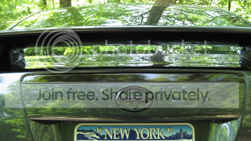

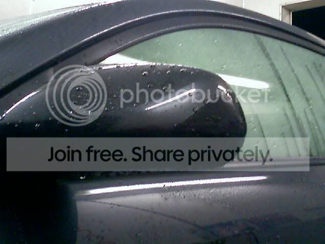

i tinted my tails, 3rd brake light, and mirror turn signals today. i'll have more and better pics tomorrow but here is a little teaser.
*tail lights and 3rd brake light*
*mirror turn signal light*

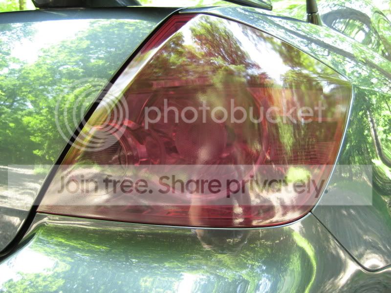

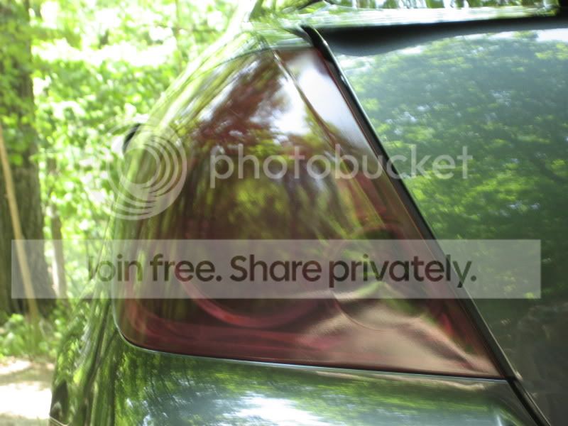

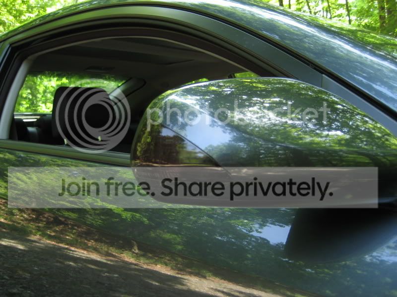

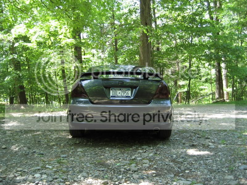

here are some nice pics with the freshly tinted tails... they still look a little dull. i have to wait 48 hours to compound them. hopefully i can get a little more shine out of them.

you have to put the clear on really REALLY thick. keep spraying it till you can see reflections in it. there will be a thin line between the right amount and running though.

thanks bud, yea they look even better now that i used some scratch-x an then the NXT wax on them. they shine pretty good now.

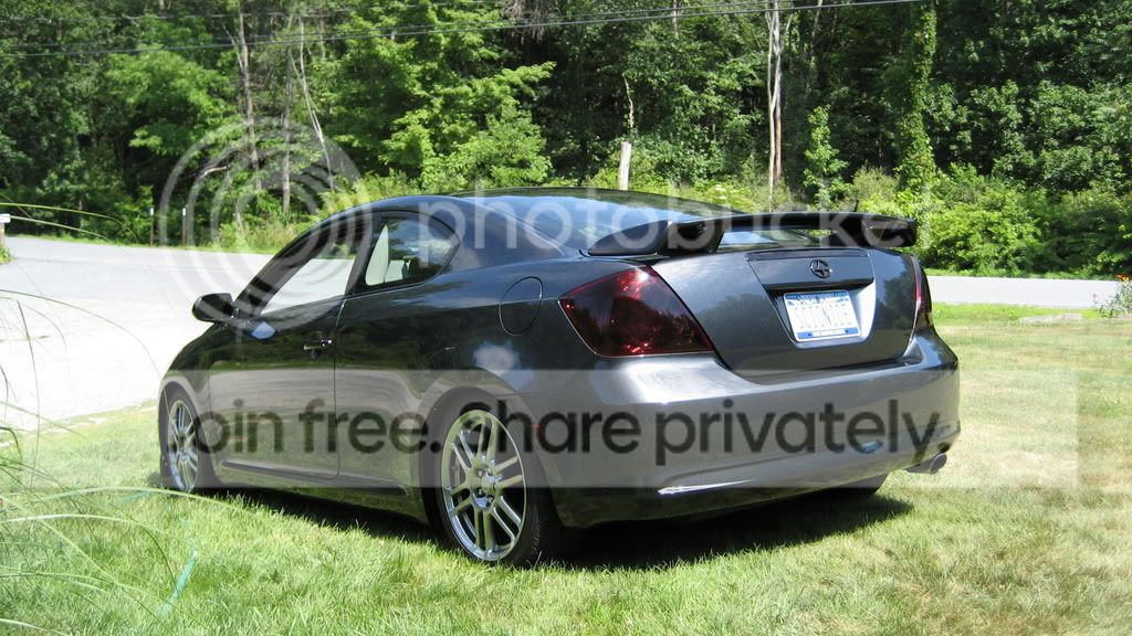

well since this thread has come back to life i will post up new pics of my tail lights after wetsanding and buffing then to a perfect shine.
