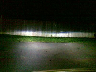

1st - DO NOT run purple 12K HID's unless you are on a showfloor. Illegal, and the purpose of headlights is so you can see in the dark... ever see violet on black paper? not a pretty sight lol.
The Prius runs D2R OEM bulbs (R denotes REFLECTOR). The housing is reflector, BUT... the cut-off shield is designed to reduce the glare. Your OEM TC halogens will glare all over the place because it was not meant to run factory HID.
Your best route is to do this...Here is the 08-10 OEM projectors, MODIFIED for no "squirrel spotter" aka glare to light up the signs.
