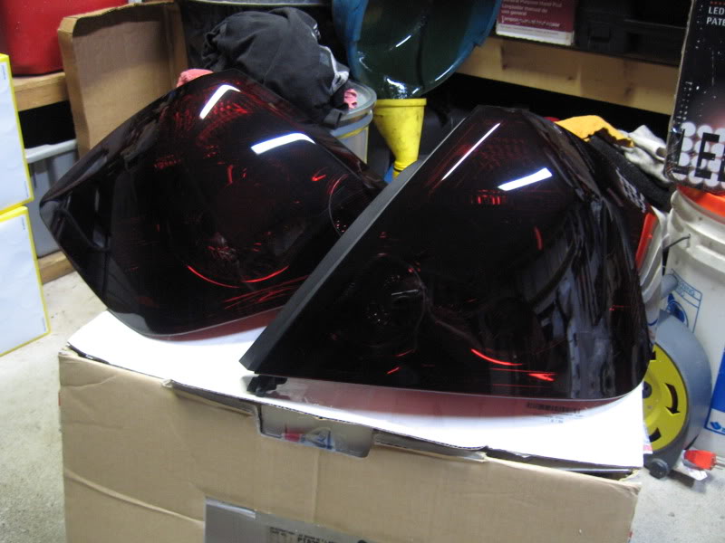

I've had the same thing happen, on a TYC tail and on a third brake light. More than fisheyes, these were 'cracks' that appeared on the surface, actually went down into the plastic itself. I've tinted multiple tails and TBLs, but it only happened on these two particular parts. I did the same - resanded and prepped, same thing kept happening over and over. Other side tail came out fine, two other TBLs I was spraying at the same time also came out fine. It looks like some kind of chemical reaction, between the plastic and the clear coat. Very strange.
And just for the record, yes, that does look like crap. This is how it looks normally.
how many coats of vht did you put on those tails?
Old Nov 16, 2011 | 02:45 PM
Lil_Deuce_tCoupe's Avatar
iTrader: (9)
Posts: 1,785
From: Sutton, MA
Don't remember - maybe 2 or 3. Works best if you do it in light coats, until you get the darkness you want.
Old Nov 16, 2011 | 03:03 PM
Cody2005's Avatar
Joined: Sep 2011
Posts: 74
From: Clinton, MO
i did my tbl and it turned out dark black and it looks good but if i did the other lights as dard you would't be able to see them as well. i just wondered cuz yours looked just right.
