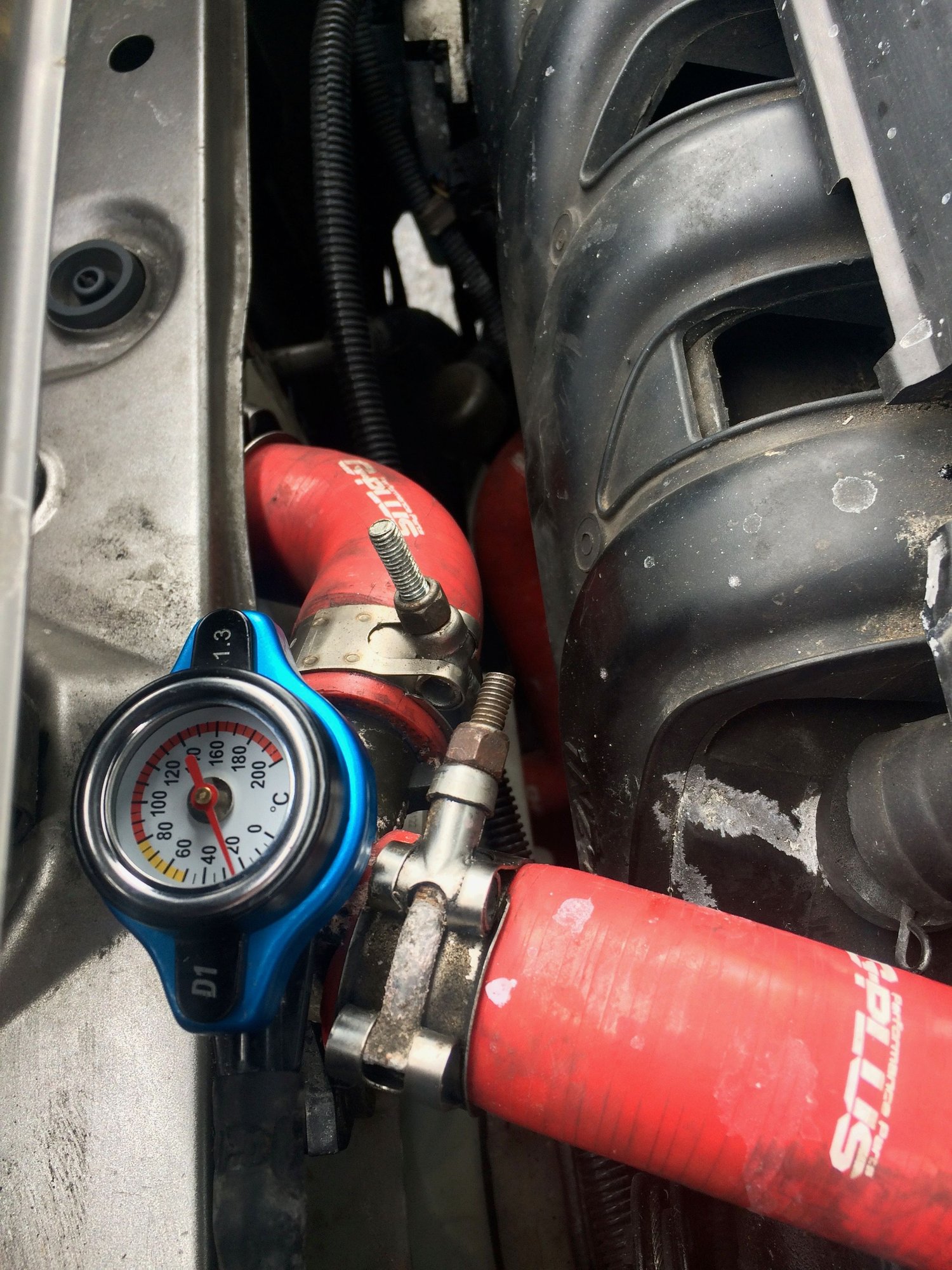

I respond to your question because I had that problem in the past with my Scion xB 2004. After that I end-up getting me a new radiator cap that have a thermometer ($6 free shipping).
Here in this platform are many experienced mechanics. Even that now they have holidays will respond to you later.
Happy Passover!!!
This is the new cap radiator with thermometer. I never go out there to check the temperature! My interior heater gives hot air out (140 Fahrenheit) in the cabin.
