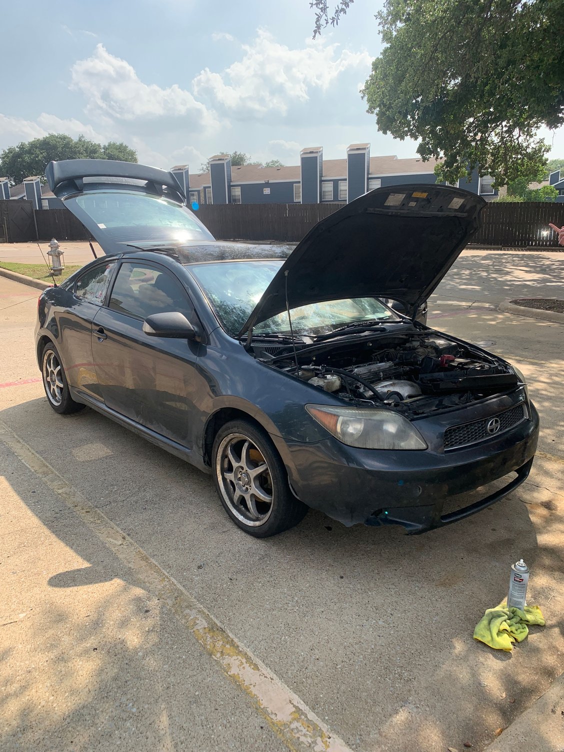

So, Me and a friend bought a 2006 Scion tC for $300 a few days ago. It’s got 200k miles, it’s an Auto. So when we went to get it all it would do when I turned the key was click. It’s got new spark plugs (done by previous owner), I just put a new battery in it (Cheapest one from Walmart haha, date is 11/19),
and had the Starter tested at AutoZone. It tested as perfectly functional. I also personally took it apart and inspected it, it looks good, all gears are in perfect shape. I checked all fuses (I had blown one when trying to bypass the purple starter relay, replaced it) they all look good.
Does anybody have any ideas? I’m going to try manually turning the engine today, as soon as it stops raining.
