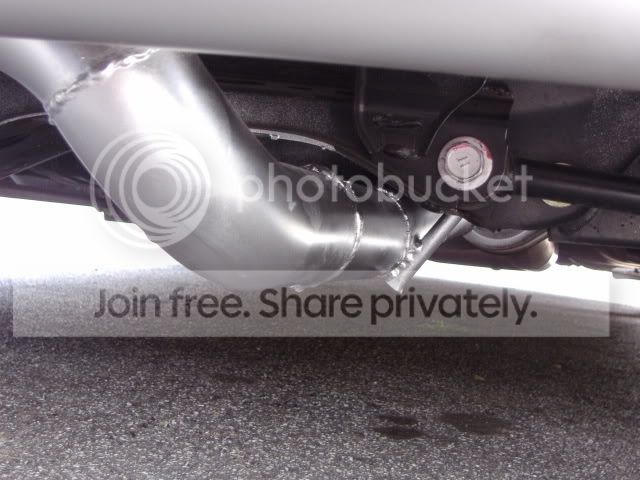

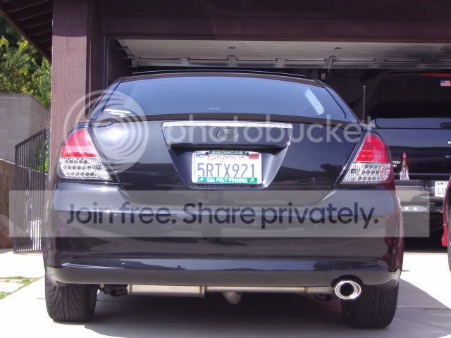

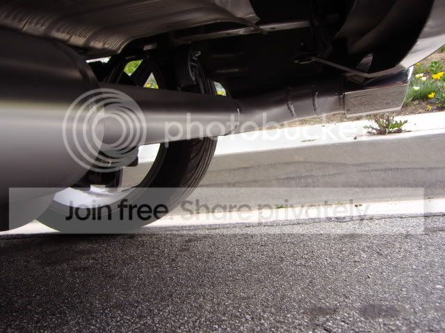

hey tc 909 do you have any pics of your exhaust set up? or at least of your axleback and magnaflow muffler?
Old Jun 13, 2007 | 07:01 AM
  #77
tC9o9's Avatar
Posts: 5,327
From: Nine-Zero-Nine
here are some..
its basically a mock up of the magnaflow cat, but in my own way:
hope that helps

Does sound good in that clip. Like your setup - cat helps vs. rasp and looks like you're using same side inlet/outlet axleback muffler - much quieter than a straight-through fartcan.
I think you are actually using a large muffler. That "30" resonator" if it's a Magnaflow it's probably a straight-through muffler. Do you have the part number?
It's also hard to tell how high in RPM's you're getting up to on those short runs. Do you have a "driveway" video clip where you're revving in neutral from idle up to near redline?

did you do all the fabricating? You should build a couple and sell them. You'd make some good cash. Sounds good in the clips. Thinking of copying you set up.

Of course he has no rasp...Hes prob got a 6" round 30" long magnapack under there OR some 5" round 30" long glasspack of some kind and what looks like a "chambered" muffler in the back AND a CAT pffft... hes prob only seeing about 6 of the 11 to 12hp that megan manifold is giving...but i bet you his low ent TQ is great
thats pretty damn close to the "stock" systems set up that he "with out even trying kinda" decided to run...
