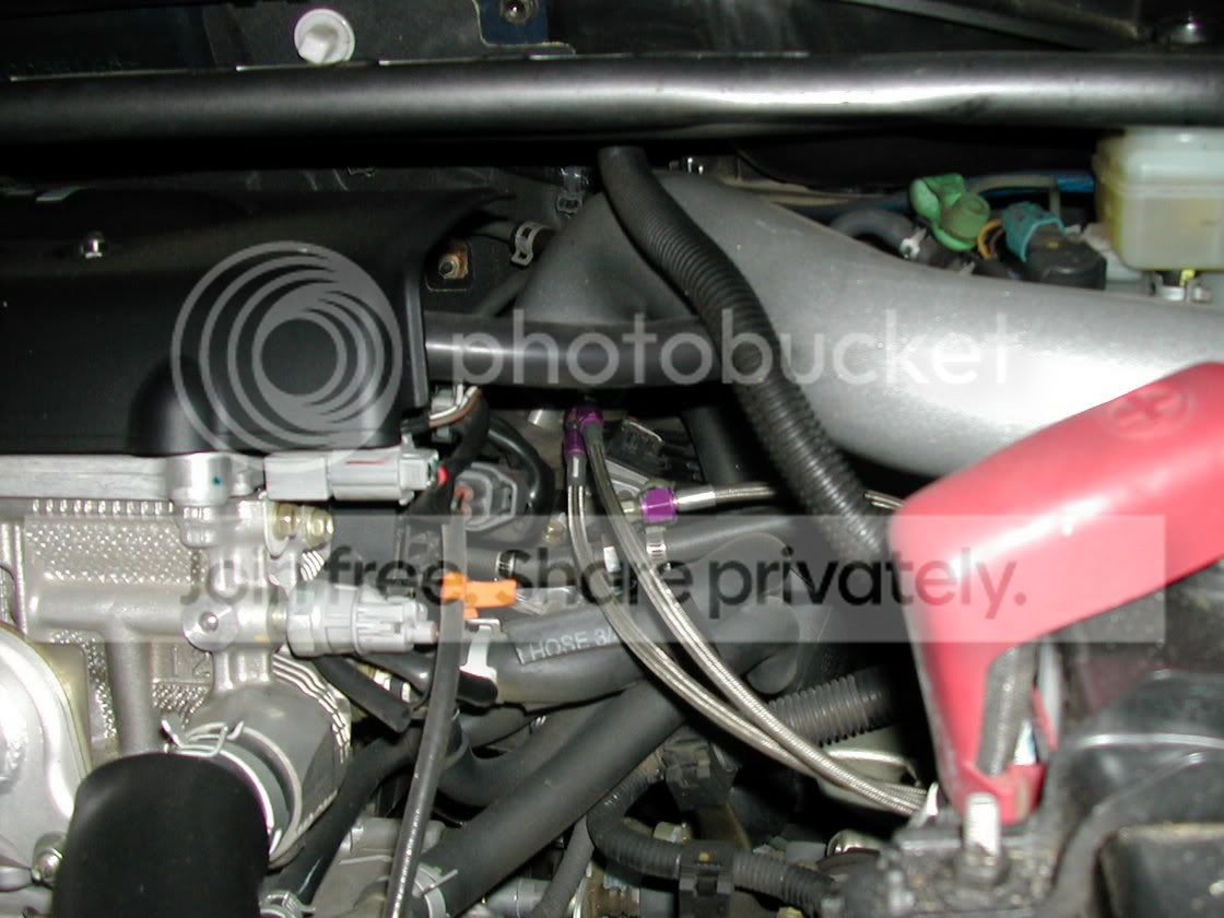

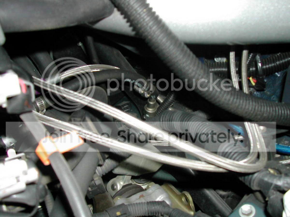

I don't know if you can tell or not but we ran a new line and just T'd off of it. running this T to the zex box. I'm not using a wideband o2. I have installed the zpi bypass o2 sensor to get rid of the cell light
As far as the tuning the car we didn't do anything special for the zex system. The system tunes itself. depending on what pills you use is what the system sprays. You need to retard your ignition depending on what you use. We did tune the car at the dyno when we installed the vvti controller.

Wow... those are so close I'll have to take them and print them out and hold them up to my engine bay to see where each picture fits... anything a little zoomed out, so I can see as much of the fuel line as possible.... Looks like you killed the fuel line from the bottom of the car in the engine bay to the fuel rail and replaced it with an easier hose to work with and t'd off it... is that correct?
I'm going to attempt to t-tap the stock hose and see if I can work it out... if not, this looks like a good option as well....
Thanks for the pics.... Helps us all out!

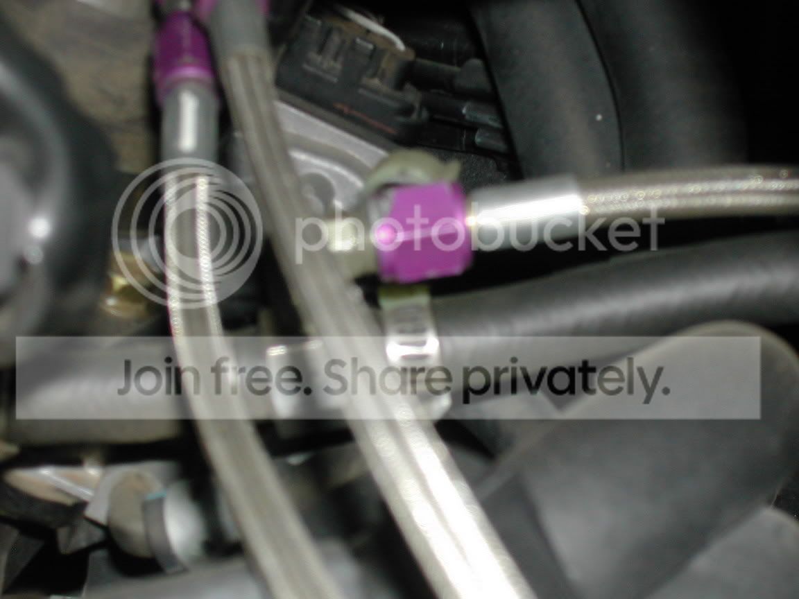

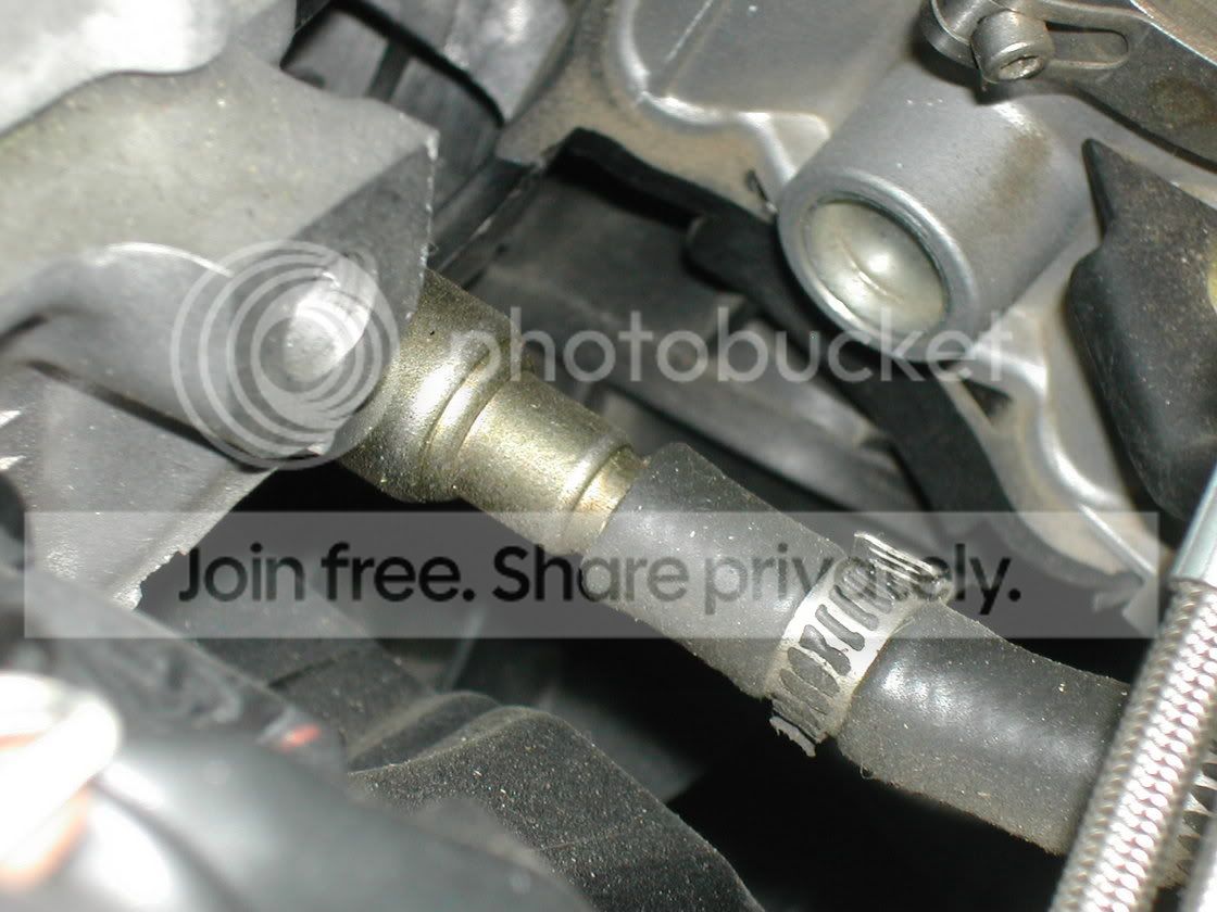

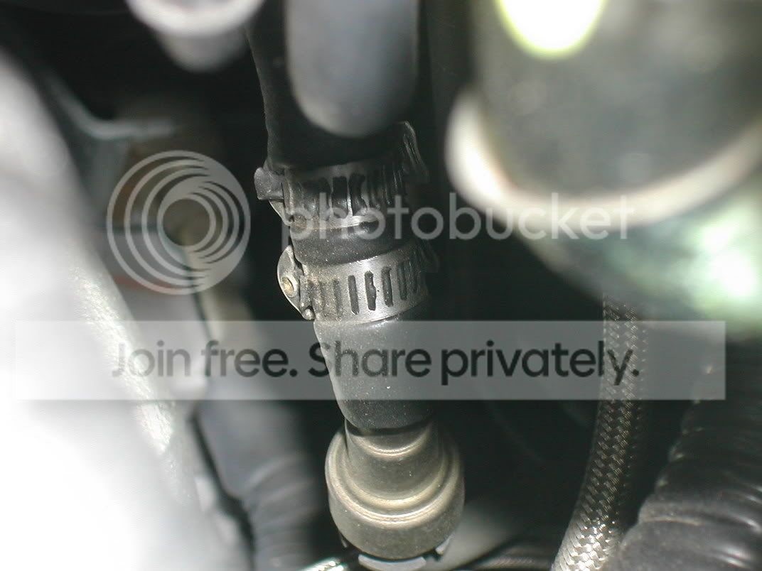

maybe these will help you better. the length of the line we replaced is about a foot long.
Old Jan 4, 2006 | 01:29 AM
  #79
WeDriveScions's Avatar
Posts: 5,594
From: Portland, Oregon
Interesting where you put your nozzle.... I put mine about 4 inches under the pipe.... Here's a pic of mine.... I'll look at what you did this weekend... My new fuel hose is coming soon I hope...
