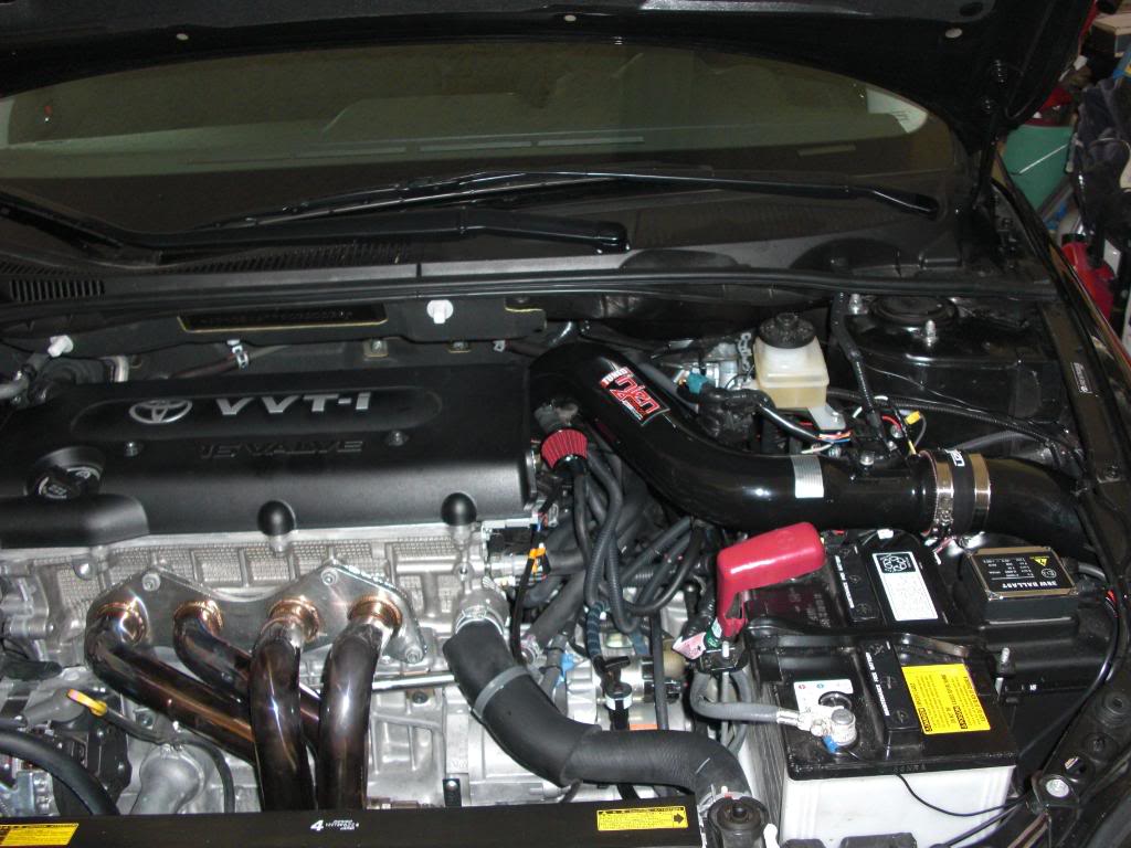

Old Aug 13, 2009 | 03:41 PM
  #91
krazyjvilled's Avatar
Joined: May 2009
Posts: 368
From: Florida
Here's a pic of my Megan Header... can u tell if this would have the Supercharger sitting on one of the tubes?

Wow...late response, I haven't been getting email notifications for this thread anymore, I just happen to stumble on to it today. Now to answer your questions if you still care, yes the MMW header should work with an 09, don't think they have any changes to it except for the heat shield, the S/C will still one of the pipes of the Megan header, I've seen it in person.
