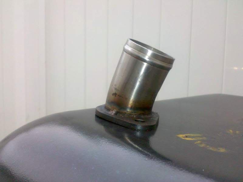

The adapter should look like this one that should be bolted to the turbo. I just took a pic of a spare one I had sitting in the tool box. As you can see, it curves from it's flat mounting surface.

yes what travis posted....btw are your trying to clock the turbo while tis on the car if so lol thats your problem bud...
