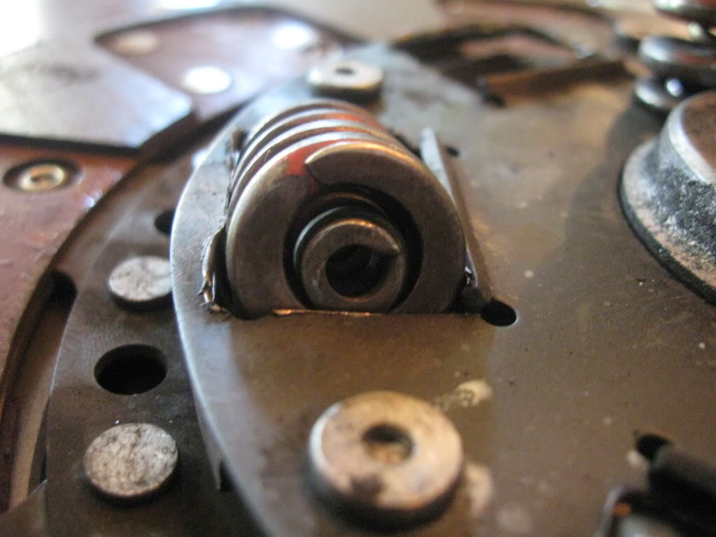

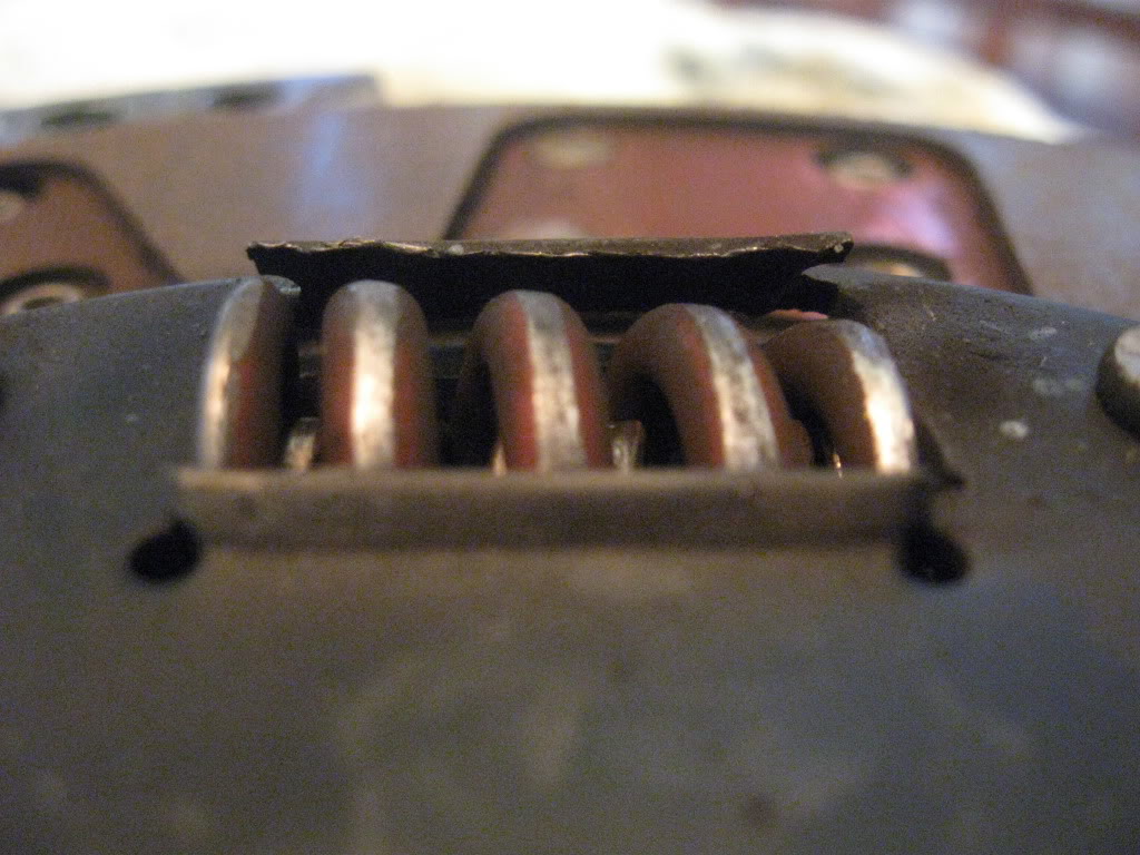

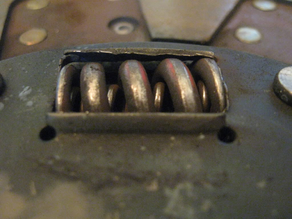

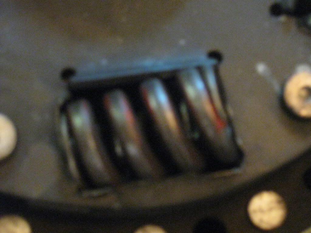

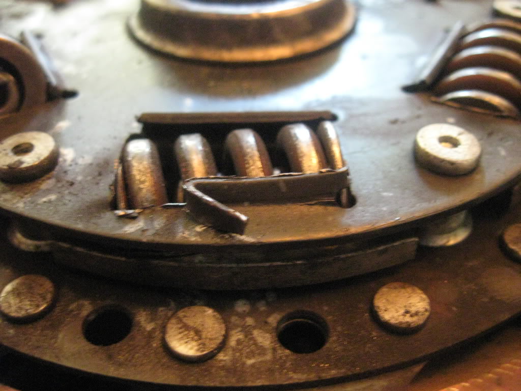

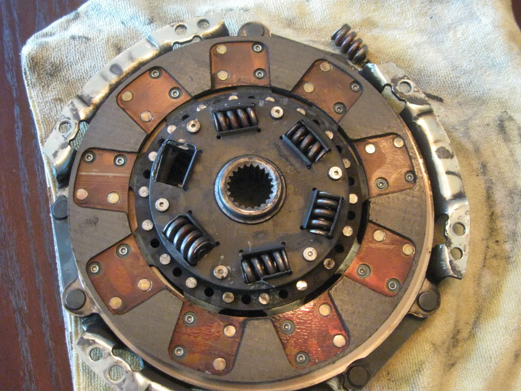

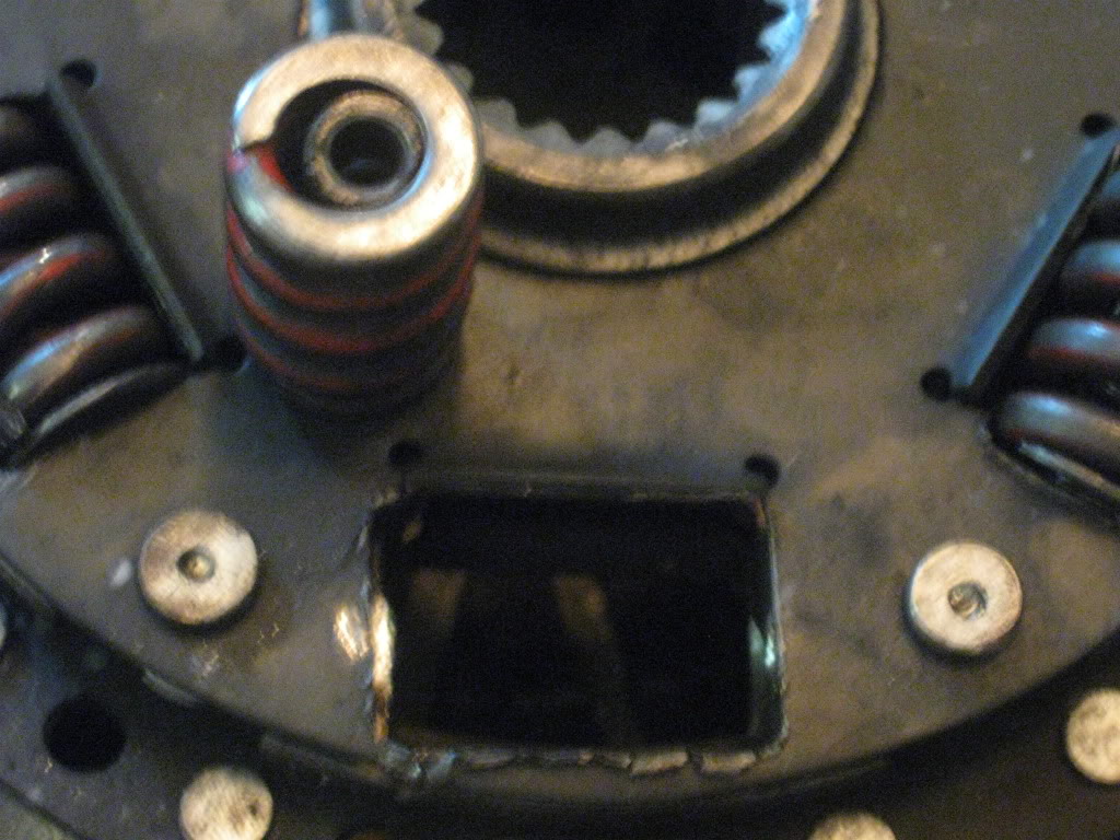

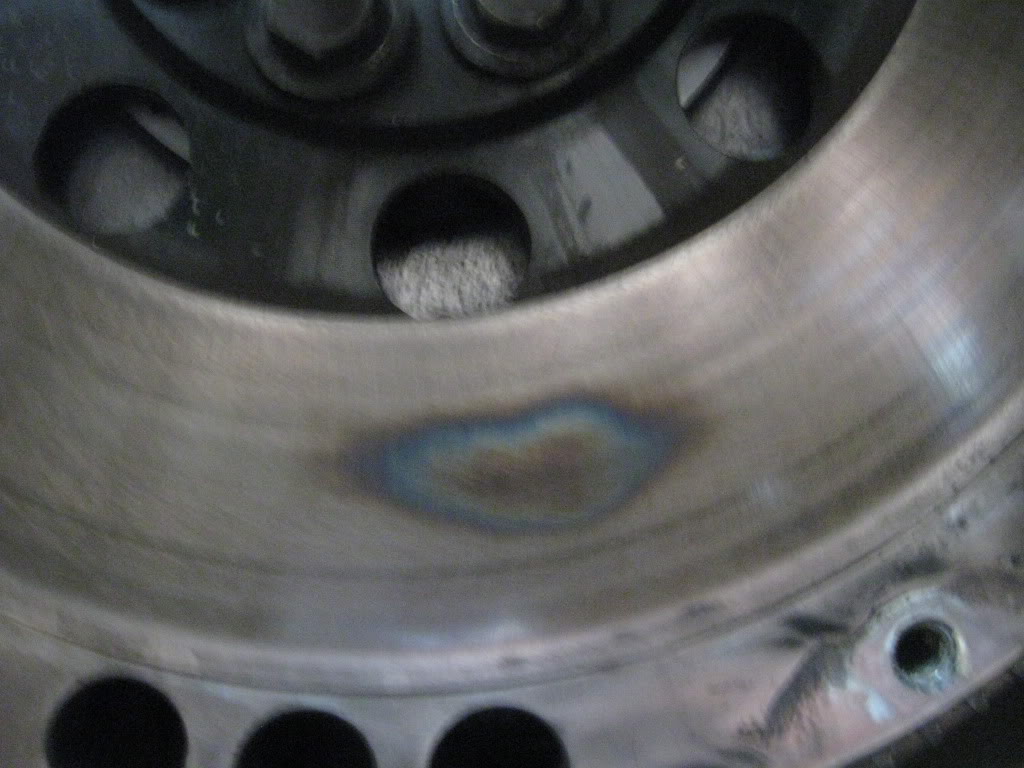

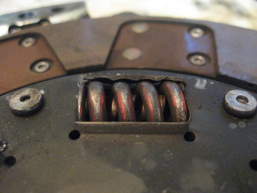

Lets get some of the usual questions out of the way...clutch had less than 10,000 miles on it. Had seen only 4 runs at the track. I even have the vids of the car going down the track posted on youtube so you can see for yourself the launches were easy and not just dumping the clutch. However from some of the pics it looks like the clutch was slipping at some point. Two step launch was never used but no-lift shift was via wot box. On one hand the clutch wasnt exactly babied but i expected better from a stage 3 clutch with a car that is putting out 240-260 tq. Maybe im wrong, ill let you guys figure that out.

here are some pics of the pressure plate and fly wheel, looks like some slipping going on. could be driver habit but with that i would think there would be less shock load to the clutch. perhaps im wrong.

btw guys this is a stage 3 clutch not a stage 4....stage 4 is a 6puck clutch plate if im not mistaken....so perhaps the wrong clutch was used...not sure at this point. this is off of Carlanga's car (Carlos). I helped him install it and uninstall it, at first i thought it was the TOB cause he couldnt shift it but found out the spring poped out and was between the pressure plate, so i guess that was keeping him from shifting.
