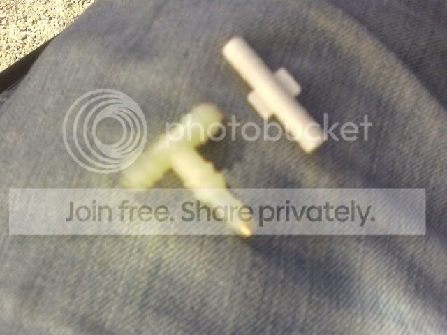

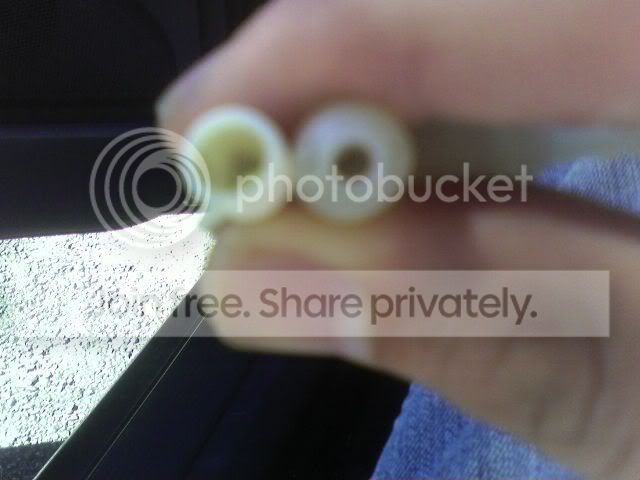

Ok so I noticed that after hooking up my boost gauge I began to hear a loud tapping noise from time to time at idle. It sounded literally like a helicopter. It was drving me nuts so i went to the store and bought 6,35 straight fittings i believe. I took out the supplied T fitting and replaced it with the proper sized Straight fitting. The inside of the T was very thin despite the T actually fitting snug on the line.
When I replaced the T fitting with the proper sized Straight fitting the noise went away. Here are some pics comparing the size of the T and Straight fitting :
Now im looking for the right size T fititng, but im having a hard time finding one. They sell them at the local auto parts store but none of them have the little metal piece inside the long part of the T fitting (the resistor I believe).
