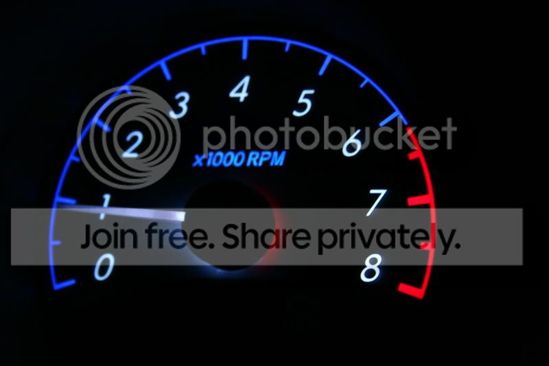

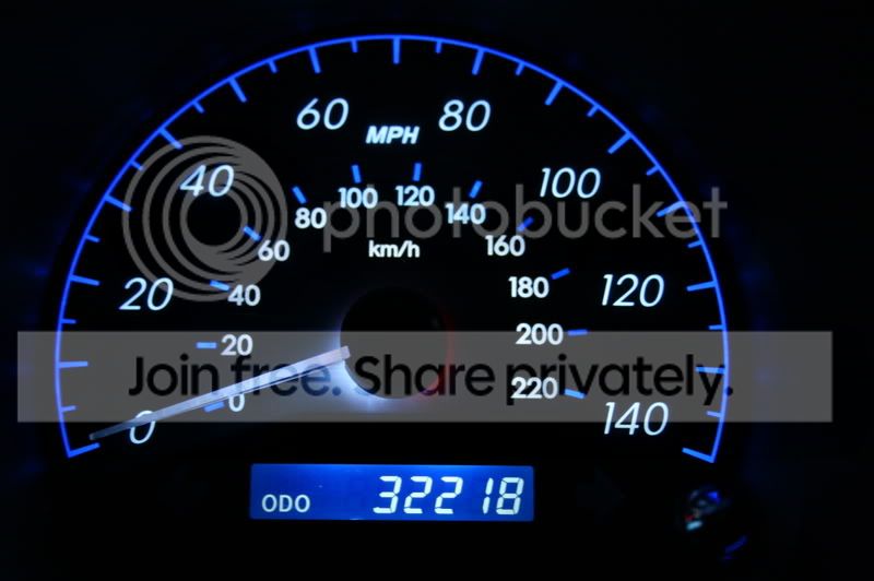

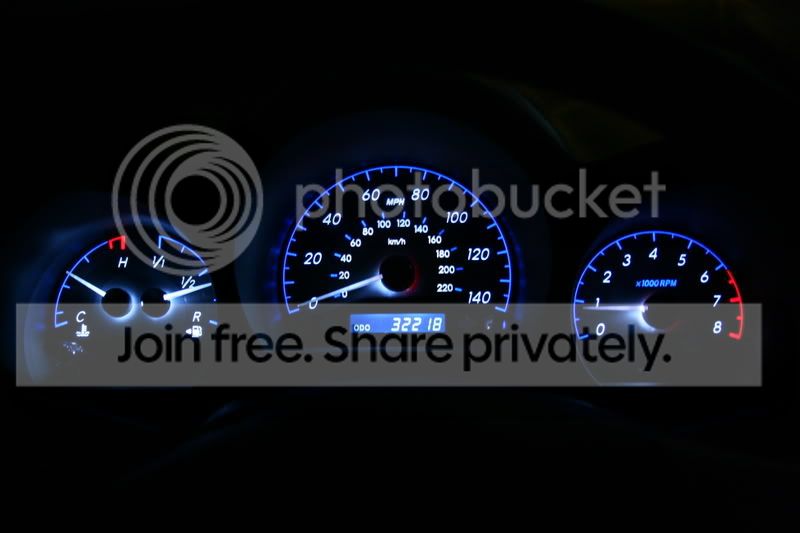

Hey jon and ace do you guys have better pics of your gauges n hvac. cuhz ace you said you have blue and jon you said you have all white in that last pic. but both of ya'll look the same color to me..

I think we both have two toned led swap, white leds with blue film at the back of the gauge faces.. the difference we have is the are that we placed the blue film and our needles..

My blue was much deeper than Ace's. The white is hard to capture when you're not taking a direct picture of it. Most of interior shots make them look all blue.

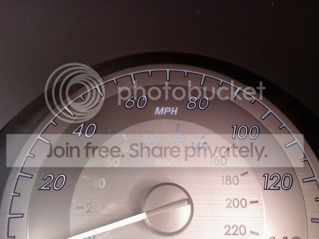

Just took a quick shot with my cell phone lol.

do you want a richer blue? you can do all blue leds too but cant do the numbers white.. carbons last pic is like a light bulb shot so it doesnt look blue coz the aperture is too open

carbon are you using all blue leds on your latest swap? yeah that one is a richer blue.. that was my first led swap but got bored so i did something a lil tricky hhaha, might go back to that soon since i have a spare gauge cluster

GReddy_tC's Avatar
Posts: 935
From: Jax, FL
Originally Posted by CarbonXe
Just like that.. But with white needles
Old Dec 2, 2008 | 01:11 PM
  #1640
CarbonXe's Avatar
Posts: 16,638
From: Parsippany, NJ
All white LEDs with all red LEDs for the warning indicators. It's the best way to go. I used a blue film behind the face plates to make the two-tone. I just used that colored saran wrap ____ (can't think of the name..) and cut it out. One layer was too light, two layers was about where yours was, and 3 layers gave me the nice deep blue that I wanted.
