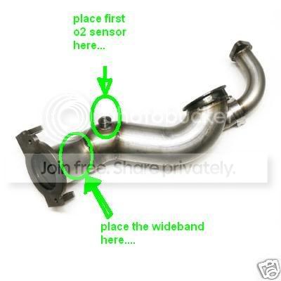

weld the bung on the down pipe, u dont have to put it after the first o2 u can put it before around 6-8 inches from the turbo is optimal. and aen u do realise it doesnt matter where u place that wideband, its change in sniffing potential isnt drastic

From: NJ
Get too close to the turbo and run high egts and you will be buying new sesnsors in short time.
like i said 6-8 inches thats optimal

thispecialk's Avatar
Posts: 367
ill have then put it exaclty in the middle between pirmary and second o2 sensor

From: Germantown, MD
put it on the down pipe right b3fore the flange that connects to the spipe...perfect spot

Posts: 1,027
From: Long Island, NY
if your boosting, why dont you buy a aftermarket spipe with a pre welded bung?

Posts: 367
do u happen to have picture i have no idea wat a flange is. sorry newbie here

Posts: 2,893
you really....shouldnt be boosting if you dont know what a flange is but here...

hotwheelsrs1's Avatar
Posts: 661
dude seriously lol, theres a picture in the instructions, it shouldnt be this difficult lol
