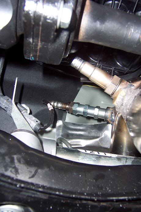

Autozone or the likes sell a spark plug non-fouler HELP! Part # 42009, has same exact thread as O2 sensor. What you do is buy 3 (2 packs for a total of 4 but only use 3). Bore one out with a 1/2" drill bit. Thread the secondary O2 sensor into the one bored out then thread the other 2 non-bored into that then thread into s pipe and done, no cel. I did this and passed OBDII emissions test twice before selling the car. PIC:
*The O2 sensor with the non-fouler is the secondary, the other is a wideband.*
Brand HELP! part # 42009
bored out

^^TN only does the OBDII plug in. That's how I pass emissions...Anti-Fouler trick.

/\/\ yup yup, plus this cost then $5
