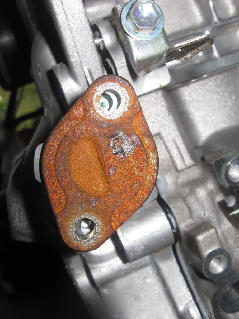

yev there is two nuts that hold the tensioner on, its fairly simple, unbolt the old, pull it out, take the new one and compress it. there is a little hook that you will use to old the tensioner compressed while you bolt it back in. once its in take a long flat head to flip the hook out of the way...now most of the time you can get away with just rotating the cam back and forth (without the chain slipping...be very careful of that) and that will push the tensioner back far enough to push the hook out of the way. good luck yev!!...btw if timeing marks are aligned then this process shouldnt require you to reset the timeing...but be careful, without a tensioner timeing may be off...so triple check it.
Old May 3, 2011 | 08:27 PM
  #1031
crush02342002's Avatar
Posts: 11,271

Thanks Chris ! Man i wish you were here so we can do it right now !
Chris do you have a picture of how tensioner looks like installed ? I'm trying to find a diagram that will tell me location of it so i can get an idea of how to get there the best.
Is there a way to verify that my cams are not stock ?
EDIT: Damn Chris you are a true G ! you posted those pics as i was typing this message to you !
