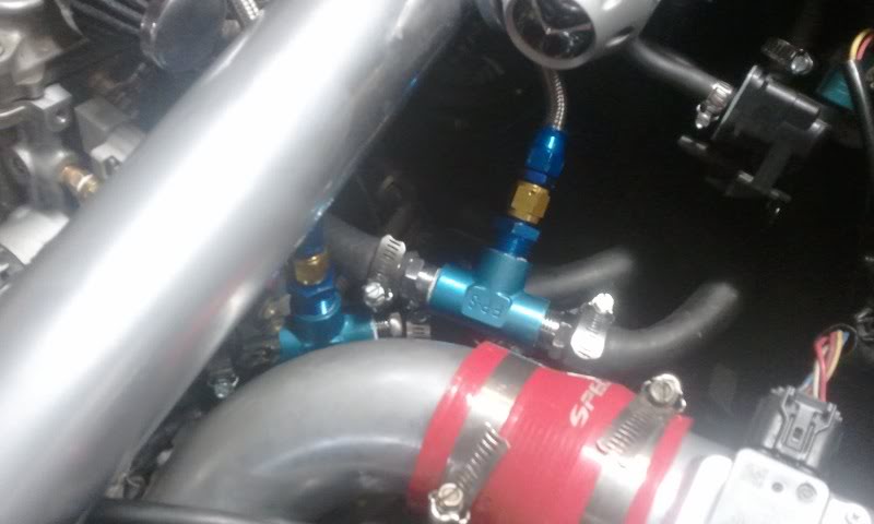

Some cool T fittings so the oil flows to the turbo right when i turn the key on

From: Bakersfield, CA
Does the 16g or 20g really HAVE to be water cooled? I know plenty of people with zpi kit just running them oil cooled.
Old Dec 4, 2011 | 11:42 PM
K0rupt's Avatar
Joined: Dec 2011
Posts: 90
From: PHX AZ
YES!
Thats why the turbo i got in my kit was so jacked up. He was only oil cooling it. it was so messed up the shop i took it to has nvr seen a turbo that bad. But why not run water lines and oil? all its going to do it lengthen the life of ur turbo and heat is cars enemy so any little thing helps

do both water ports have to be tapped with water line fittings to be water cooled?
Old Dec 5, 2011 | 12:16 AM
K0rupt's Avatar
Joined: Dec 2011
Posts: 90
From: PHX AZ
I only ran 1 With -6AN steel braided lines last year. And when i went to add 2 more on i couldn't get the other 2 ports out of the turbo they have to be seized but i would.
I also live in Arizona so for summer i wanted to dump as much water as i could. But the research iv been doing turbos are cooled more by oil then by water. But i if u go to my progress build pics of this year and see my turbo in the first pic on the right that what happens when u don't run water.the case turned brown it over heated like crazy.
Thats why i want to do an oil cooler for my turbo cus the oil does most of the cooling
