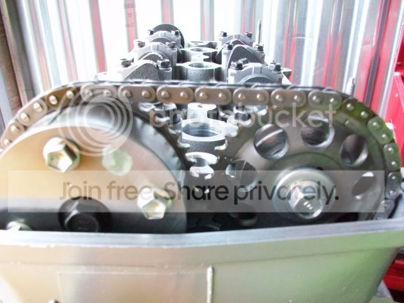

yo yamaha....can you take a picture of the face of the intake cam.....so i can see the timing mark....there is a dot and a dash....i want to see which one is the timing mark.
this toyota spec.....youll notice the colored chain links line up as well.

gingles's Avatar
Posts: 1,881
From: Denver, Colorado
cool....thats the problem with mine then....i lined the intake cam with the dot instead of the dash.......but now its right....gonna finish it up tonight and try again.

i am marcelo.....haha......my buddy is gonna be here late tonight so it will be in the am for me to do it.......but im 90% certain that is what was wrong with mine man.....i know for a fact intake cam timing was wrong.

I'm willing to bet thats your problem.
