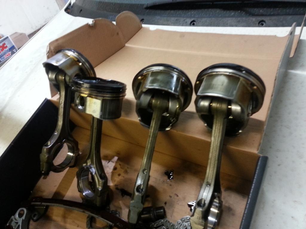

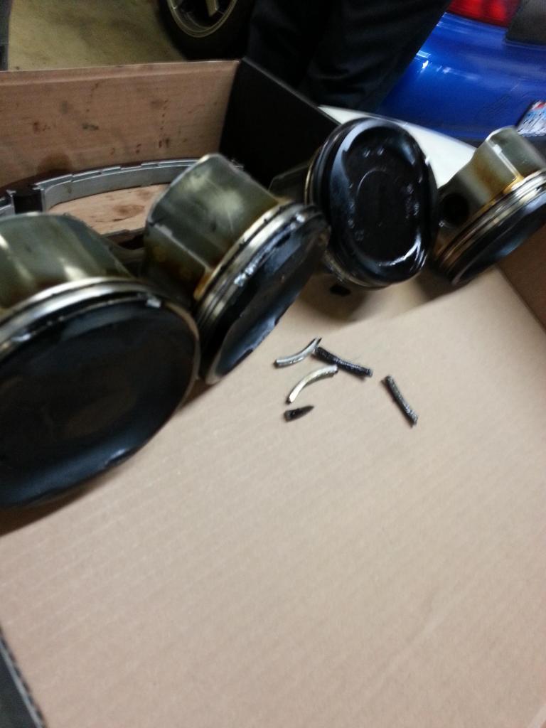

Motor getting ready to be sent off to the machine shop
Damage done to the 4th cylinder, very minimal scratching, a fingernail can't be caught in it.
and last but not least, the ring landings went out and chunks of the piston broke off as well, some of the bits and pieces were found in the oil pan.

Posts: 11,271
ring land death...lol

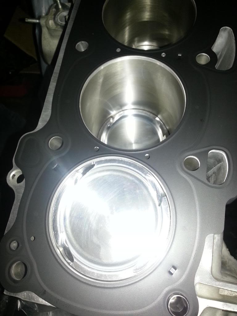

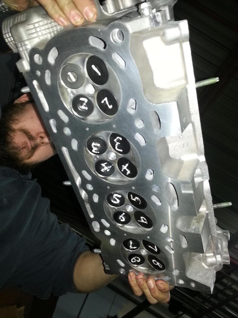

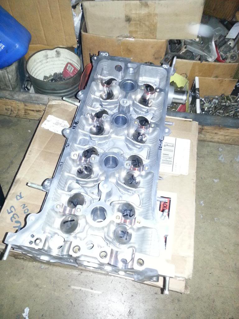

Made a stop by the shop yesterday, and they already started assembling the engine
There's gonna be a pushback because the ARP headstuds were too long, what's weird though was that the set was made for a 2az-fe block, but when they were installed they were hitting the cams. The shop tried telling ARP the deal, but they were just saying that it was the correct product, even though it didn't fit?
Were just going back to new OEM replacements.
