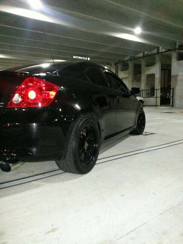

Got everything together, and retuned. 519hp 484tq, 24.5lbs of boost, 109 unleaded, 93 degrees.
Sent from my HTC One using Tapatalk 2
