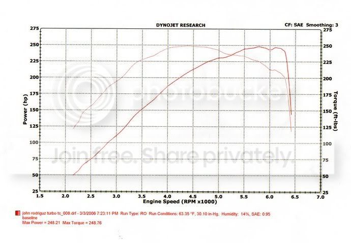

248 whp and 248 trq on stock exhaust and TRD axle back. He has an excellent AFR tune - very safe.

Now that's what I like to see....HP with the TQ to match, and not 248hp with 180ftlbs of TQ like a Honda motor.

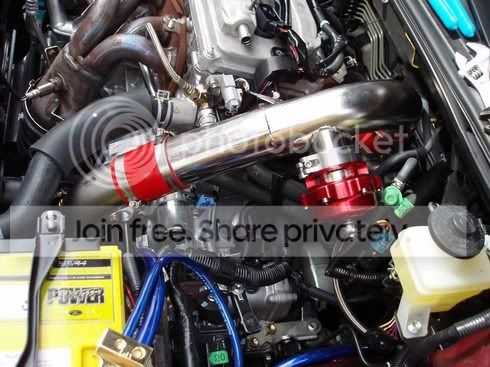

One question, Are you experiencing any stalling issues with the atmospheric BOV?

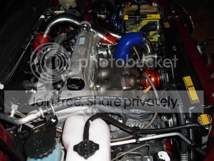

the stinger battery is equilevelant to an optima battery, the only difference is the cold cranking amps are a little lower. not an issue with a small engine such as this one. for the stereo thats in there it meets its needs. there is 2 t1 rockford 12's ported run by a bd1500 with a rockford 50 farad cap. that battery and the cap is all i need. plus with stinger, the battery is half the size of stock. need the extra room for distribution blocks and fuse holders. dont pay attention to that side of my car, those terminals will be gone very soon. all brand new wiring and terminals should be done by the end of this weekend, depending on when i can make time.
the mustang that was drooling over the power had an 05 gt with a few mods done and he dynoed 190 whp with around 315 tq. he was a little upset that the tc was that impressive.
this is a conservative custom tune. im not a racer but i do drive fast. its still boosting 10psi, but at a very safe a/f ratio. as far as the 300 hp thats advertised, sciondad informed me that you have to have their full exhaust. they had their full exhaust on the 300hp tc they dynoed. believe me, 248 is more then enough.
stalling. at first yes i had alot of problem. even though the kit is pretuned, you really need to tune it to your car. now if i drive normal and go to stop and throw it in neutral, no problem. but if im sitting at idle and i tap the gas, it will drop to 500 rpm and sputter a little. only because its running real rich. the performance shop recommends getting a recirc/atmos bov but i really like the one i have, unbelieveably loud.

the wastegate is going to open up. its suppose to, your only gonna get 10psi of boost. if you plug the wastegate, you will boost until your motor blows. the 10psi regulates the pressure.
not understanding the unclocked question. this kit was on zens car prior to me getting it, so it was already clocked. but as far as i know it comes unclocked.
as far as the red couplers, there are many little bugs i need to work out prior to changing the couplers. i dont think im going to leave the read though. they are really and offset for the bcp.. blue looks better imo.
