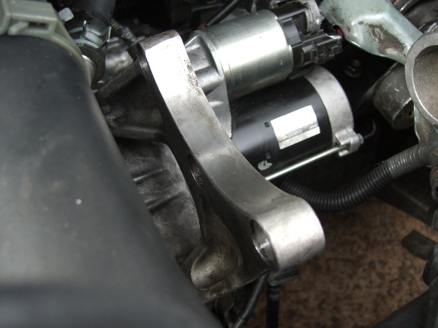

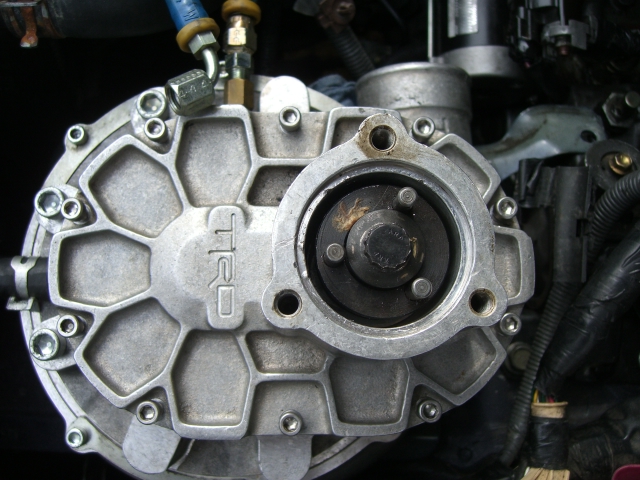

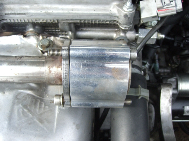

Step 1: Remove the 3 Allen bolts that thread from the shaft to the supercharger. Also dont forget to remove the oil feed line and the oil return line aswell as all the hoses and tubes connected to the blower.
Step 2: Remove the 3 8mm Bolts underneath the charger that hold it to its bracket.

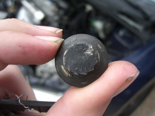

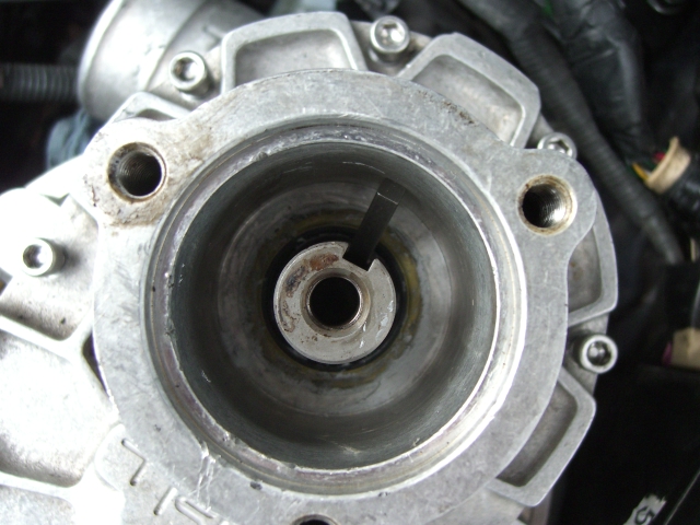

Step 3: Remove the 13mm 12pt bolt. This is what caused me all the problems with the bearings, not removing this first. It took a 550ft lbs Impact gun to bust this bolt free.

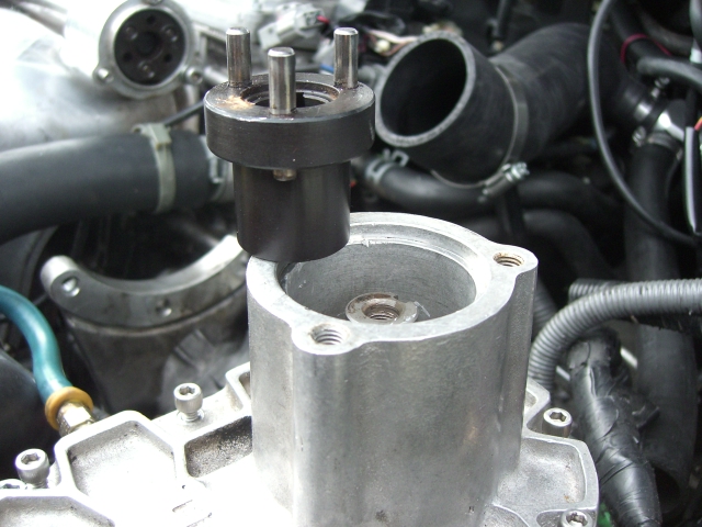

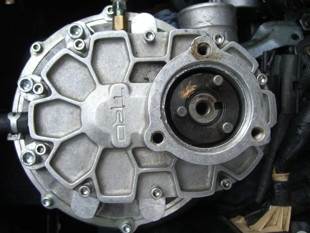

Step 4: After the bolt comes out you can slide out this black thing. Dont lose its little square key though.

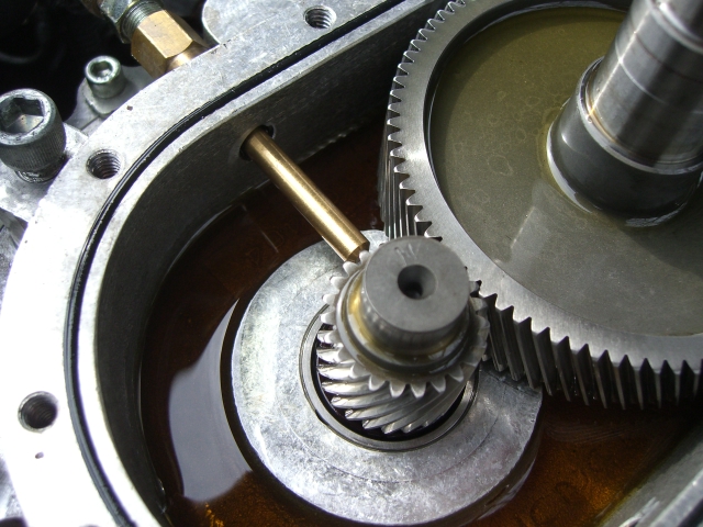

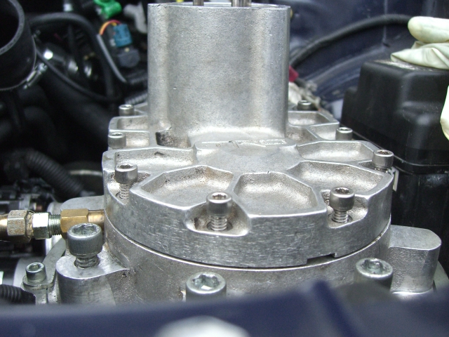

Step 5: Loosen and remove all the little bolts surrounding the supercharger. I have them loosened in this pictures. If you dont seem them here loosened dont take them out!!

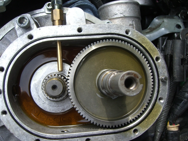

Step 6: If you look in you can see the seal. Seperate the 2 halfs of the compressor. Be very very careful that you dont put ANY stress on the bearings that are pressed in. After you should be stuck with 2 pieces of compressor, one side filled with gears, the other filled with 2 bearings and a seal. Do what ever it takes to get the seal out. Then with you new seal in hand run a nice ring of honda bond around the outside of it and press it into where the old seal was.

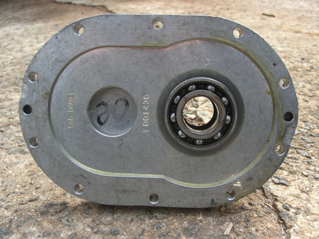

This is what you should be left with. There should be a bearing though where the little 20 is written. (Thats where mine broke from)
Rest of the pictures are just of the inside of the blower. To reinstall do the reverse of the take apart sequence.
