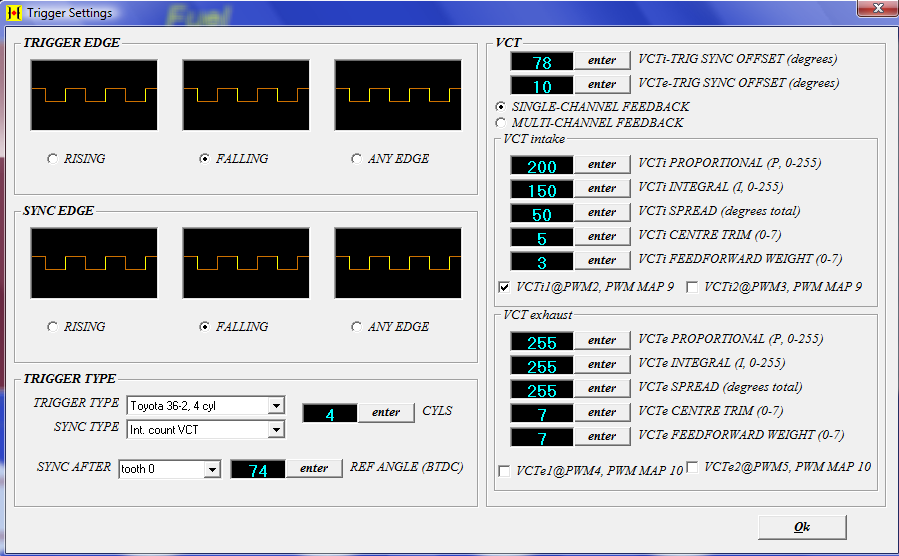

Ace - one thing I noticed on your map - shouldn't our trigger and sync edges be Falling/Falling? You have it as any edge on both.
Try copying these values and settings:

Actually Ive been 0.028, 0.030, 0.032, pretty much same result low hp.. I might try a step one colder. Actually ive been to 9 and 10 psi 0.028 gap same hp
Rob the settings i have are from hydra ems, andrew walked me through the settings and unlocked my triggers and warned me not to use any other map.. its good i almost forgot about that..

Ace - that's weird because those same settings I have were inspected by Hydra and said it should be good. dunno bro.
