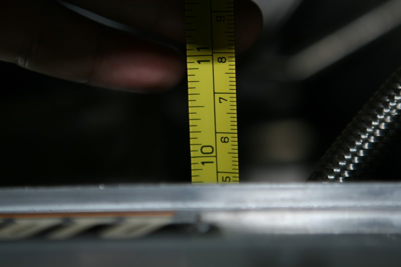

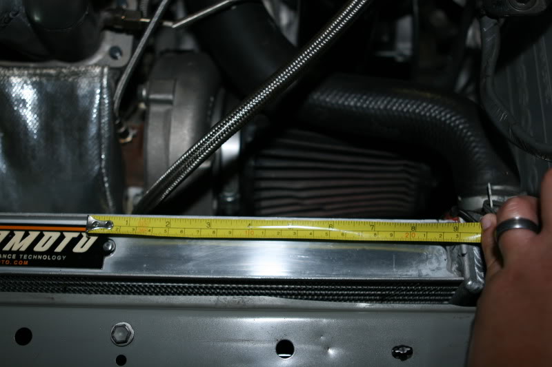

Originally Posted by paul_dezod
If you need measurements or something lemme know.
i did some simple measurements on my TT kit, just for reference for anyone interested.
measured from the coupler at the compressor elbow, about 10" from top of radiator
elbow to IC pipe coupler is about 9" away from driver's side radiator endtank
distance of comp elbow to radiator is around 0.5-0.75"
