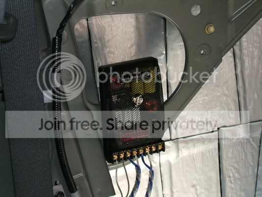

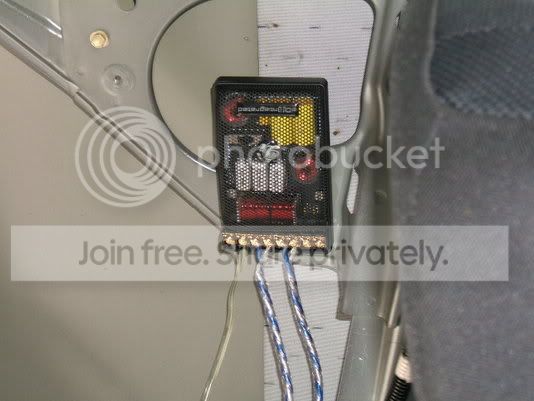

Hey Chris have some questions for you before I attempt to try anything of this nature. Like I orginally told you before buying all the stuff from eD I said I want to mount my 9.4 and 9.2x behind the panels like you did in this topic. Well here is where I installed my crossovers
Do you think these will cause a problem with the installation of the amps? Will this disrupt the airflow through the speaker grill built into the panel? And will the crossover be too close to the amp and cause interfernce? What do you think? Also any other pointers or tips u can give?

i thought crossovers where suppose to be close to the speaker.
Old May 8, 2006 | 01:12 AM
justmyluck's Avatar
Posts: 358
From: FLORIDA
suppose to be but think of all the people in car competitions with the clean installs with the crossovers next to the amps in the rear of the car. also if you look very closely at Chris (mandos) picture where he showed his amp behind the panel. Under the amp lying down is the crossover. You can spot it by the yellow. But good question... I believe it is prefered to be closer to the speakers but does not HAVE to be near them. But don't quote me on that I am just stabbing at this one.

As for mounting the amps back there, it shouldn't be an issue at all...just make sure to put the bolts not through the x-overs.
As for x-over near/far. I've always had mine far. I had them next to the comps once, and honestly didn't notice a difference. It's said that they should be close, but I can't hear it so I just put them where they fit.
