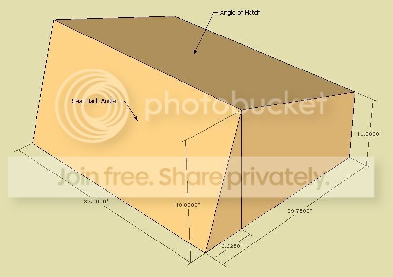

forget the costs or what your going to charge.
Heres why no one with a quarter of a brain would buy that box:
1. Weight. That box with two subwoofers in it would weigh atleast 150lbs. easy.
2. Size. By stating at it would be a 9cu. box would mean that it's 4.5cu. for each chamber. Thats still 2-3.5cu (per chamber) larger than the average speaker's specifications. A box of that size would produce the same result as an infitite baffle design.
Constructive criticism: Learn the basics about subwoofers and box design before you come on here claiming to have the golden key.

First off, I am not here to spam this forum but only to address the OP of this thread for which I have to say the following:
You my friend are nothing more than a ripoff artist and you got no business even trying your hand at designing, let alone building sub enclosures!!!
I say this because the picture of the enclosure w/ dimension is an exact copy that I posted on CA.COM.
http://www.caraudio.com/forum/showpo...5&postcount=11
I know this because I am the person that measured and template fitted to verify the dimensions as to the an enclosure I have designed for a customers Scion tC at a meet we were at and a member of this forum
Second, the volume you stated is a total crock, 9 cu.ft. ---- yeah, you wish!!! The volume is 6.86 cu.ft.
Do yourself a favor and try being original and for god sakes learn about what ya want to do before going off and making yourself look like a complete moron.
YOUR BUSTED!!!
YOUR BUSTED!!!
I knew I wasn't crazy when i plugged in the number and I kept on getting around 6.5cuft! LOL glad you came in here and gave the real number! LOL Notice I used on of your pictures in the previous page as an example of a good box!

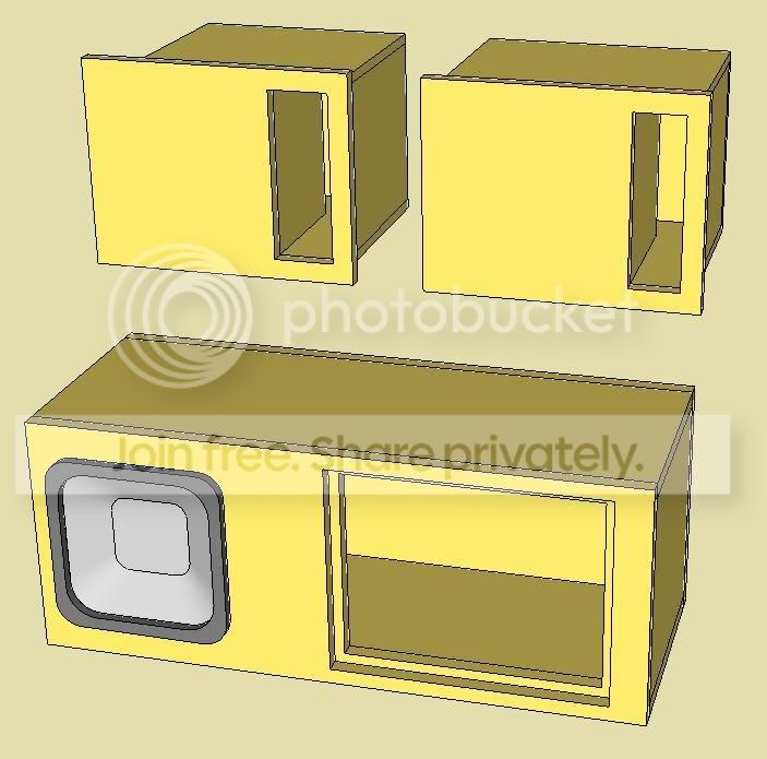

Oh yeah remember this design Phil?
That was the design you made for me.

Yeah see that pic, it's the same thing you posted, dims and all and thats 6.86 cu.ft. and the other enclosure is totally different in design and ported.
Forget what I said about learning anything because you " FAIL " big time.
Yeah, imagine that, same design, dimensions and all. Man up and just admit the truth because no one is that gullible to believe the odds in that.
You got zero credibility just for that comment alone.

Alrighty Mr I'm so big and bad because people know me. Sorry you can't accept that someone could possibly measure the same dimensions as you in an identical car.
Yes, and I meant to thank you for the " plug " but, when I tracked down this post ( WebSite software tracker ) and I saw the first post by the OP, it just p*zzed me off to no end.
Yeah, I remember that enclosure design quite well, did yu ever build it??
Dude, you got caught in lie, just admit it and move on. I can accept that you didn't have the good common sense to know to make subtitle changes to the dimensions to gain more volume because the enclosure is not even a tight fit in area it goes into.

Any taller and without flush mounting the drivers would hit the plastic trim at max excursion more than likely, that's not a chance I'd like to take.
LOL, yeah right. Per the dimensions and the template made there's a good 4" of clearance from the top of the box to the trim plastic on the hatch, more so to the glass in the hatch.
But, you would of known this if you had made a cardboard template to verify the clearances.
I'm done with this, you go right on with doing your thing, I'm sure someone will appreciate your efforts.
Good Day

No I didn't make a cardboard template, you're correct. I don't keep an abundance of cardboard at my house, and I did this all on my lunch break. Like I said, more than likely. Not promising anything, but not a chance I'd like to take.

kid give it a break ! i do this for a living . its not just measuring and building a box . for a sub to even begin to sound right there is so much to factor in. in this case bigger isnt better .its a small car 12 is the biggest you want to put in it, anything bigger your just not getting the subs full potential. 1.5 cu ft per chamber at most!

For anyone that cares, I plan to put two Audiopulse Revo 15s in it. More than likely powered by two Kicker 06ZX1500.1 amps in two separate racks under the floor.
edit: ^^^I have three 12s in right now, and had two 10s before that, and one 10 before that.
edit x2: Would it be more 'practical' if I built the box with Birch Plywood? Lighter, I'm not sure about stronger though.

For anyone that cares, I plan to put two Audiopulse Revo 15s in it. edit x2: Would it be more 'practical' if I built the box with Birch Plywood? Lighter, I'm not sure about stronger though.
So since that subwoofer's recomended box volume is "2.0 - 4.0 ft³" you are left with 1-5 extra cu.ft. of air space, which translates into an extreamly inefficient system and will not produce anywhere near expectations. I personally guarantee that my single ED 13Ov.2 in a properly ported box with my Kicker 300.1 amp, would destroy your two Revo 15s in that box, in BOTH SPL and SQ comparisons. Thats not a personal opinion. Thats a guarantee.

And to the other bit, you made the dumb comment. Two woofers, two chambers. 9 cubes / 2 = 4.5 per chamber before displacement. So a little under 4 each after displacement. Who doesn't know what they're talking about?

Ok. Maybe not exactly a "stupid" question. Just an ignorant question. It's an ignorant questions because, everyone who knows anything about building subwoofer boxes knows you only use MDF. It's the best material because it's one of the strongest materials (yes there are stronger materials, but are not as cost effective) and it has a much better ability. Read further in that thread. The kid was 17 as well (coincidence?) and got the birch for free from his dad. That build is not practical eithor. 2x 18" RE subs in a mini cooper?? Eithor a show car, or competing in SPL. Not intended to be a daily driver or be concerned with SQ.
Excuse me that I didn't take into consideration the displacement of the subwoofer. Not a dumb comment by any means. So your still barely scaping into the maximum volume for the driver. Still going to sound like crap.

Thank you for being so quick to bash me. And thank you for admitting your mistake. Yes, it will be bigger than necessary. If it sounds like ____, I'll build another one smaller. I've only used MDF personally, but the birch ply would be a good experience. Just hoping it's stiffness doesn't equate to being brittle. And I've read through the entire thread, weight was his main issue, and would be a concern for me as well.
