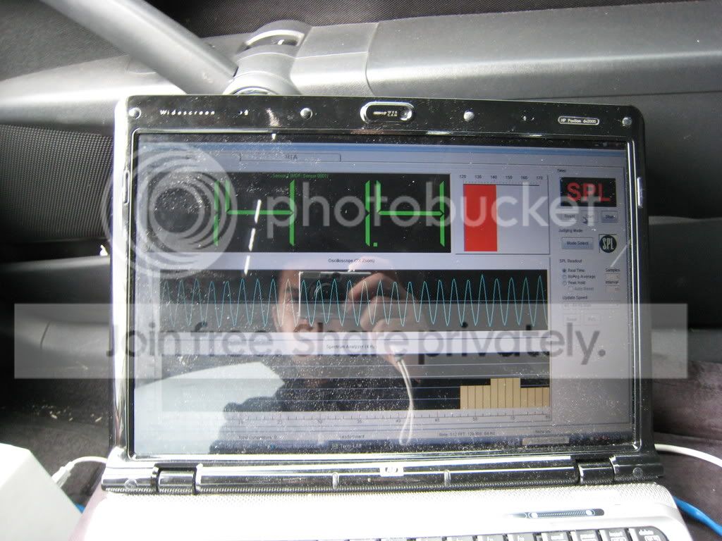

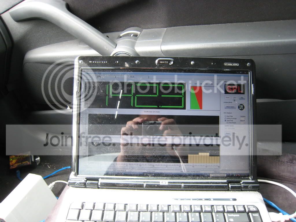

Originally Posted by tweetertc
oh yeah.. and another question.. what kind of mic were you using and where did you place it trials.. cause that can make a few decible difference..
and simple box yes.. well designed absolutely.. i saw your design.. whoever did it also tuned the port which is a common mistake with amateur and pro box builders alike..
141.4db was sealed up mic legal placement on 12" from a pillar 3" up. That was on music.
The 142.xx the mic was on the kick sealed up outlaw style. On music also.
In the picture you can see the TL mic on the floor.
I also did a 141.8db burp at a MECA show. They measure at the headrest, so at ear level basically.

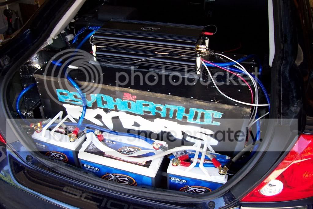

That's my install
I know practically every type of box(not counting fiberglass or any other form of box that uses molding to form internal volume. this is just for mdf or structured material that is stiff and cannot bend and mold like fiberglass can) that can fit in the tC. I had made a thread about this a long time ago but nobody cared...
The following IS for ported designs-
You can fit up to 3 12s on a baffle, but only 2 12s for adequate air space.
You can fit 2 15s on a baffle, but only 1 for adequate air space.
You can fit up to 5 10s AND for minimum requirements be able to get them in the proper box. 4 10s is the best option instead of 5 in my opinion.
You can fit up to 8 8s and in the proper box as well.
I am running 2 12s off of 4,500w of power and 3 Powermaster batts.
1/0, 2/0 and 3/0 wiring throughout.
The box that was posted from the OP, if you remove your spare tire, you can install it just like how it shows and it will fit fine.
I have all the dimensions here for what will and wont fit back there.
