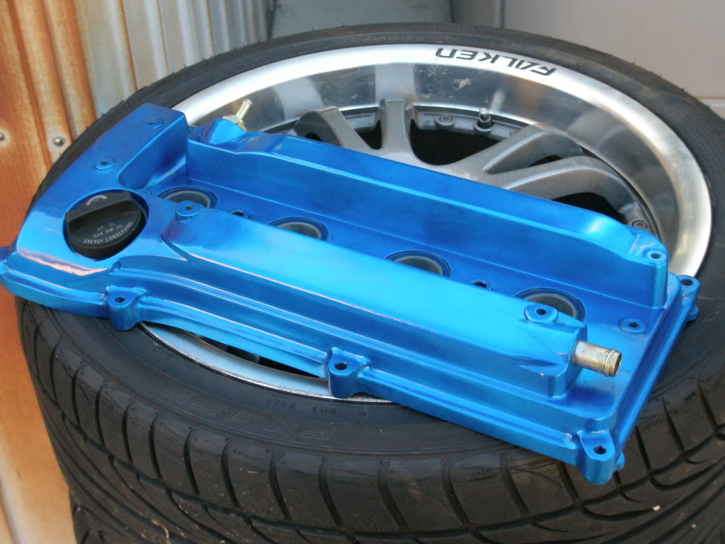

Alright guys... if theres one thing ive learned, its you need patience to do this... midway through, i was running out. But im happy with the amount of effort I put in, and the results I got. Couldve been better though. LMK what you guys think.

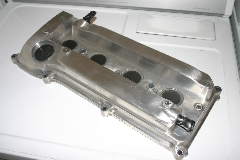

This is after sanding it down

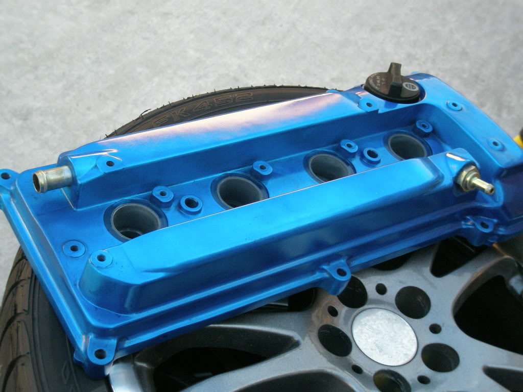

And this is the finished product...
There were a few parts that couldve been sanded a bit more to clean it up

not bad for your first one denny. i hope you used a high heat primer. these toyo vc's dont like str8 paint or thin coats of primer.
color is nice.

i used a cookie cutter on a die grinder for the casting imperfections, but it left swirls, so used a plastic wheel on a buffer, and it took most of the swirls out... then hit it with a 600 grit. shouldve gone 400 then 600, but oh well... lol... needless to say, it took me forrrreeeevvverrr... lol
i went with anodized blue, so in order for it to shine like it should, the vc had to be semi polished.
yupinmytC
