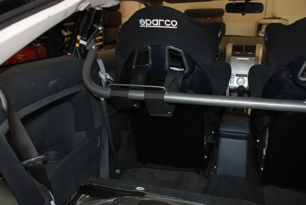

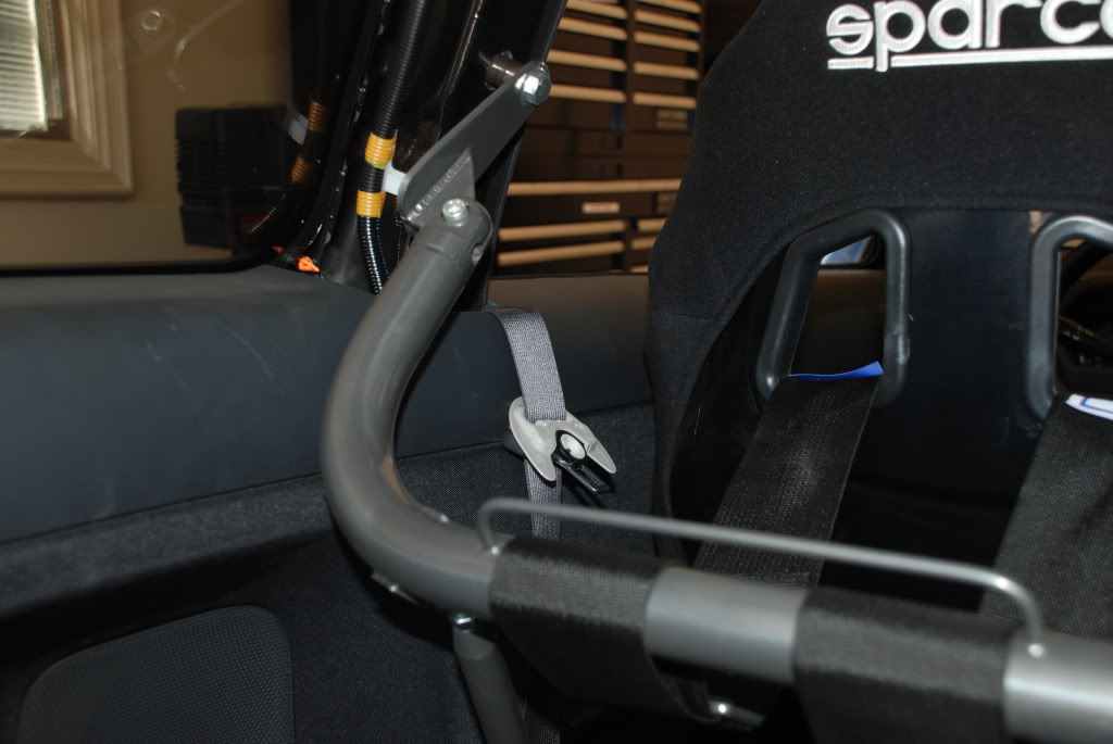

better late than never I guess
* yes the garage is dirty
In some of the pics you can see the spacers that we ran. This allowed us to keep that plastic piece intact without trimming. Never got around to reinstalling it

OK... here's some more pics. And again, many thanks to Geoff at Nurspec for the awesome deal on the bar!
I used one of the included spacers (1/4"?) here between the body and the lower support mount:
Here you can see I need to get a longer bolt for this connection - and I even only used ONE washer!
Got the 1" spacer from Lowe's and obviously haven't put the B Pillars back in yet.
So the bar is installed in all of the typical places. I do need to get some longer bolts for the connection of the supports to the main bar. The ones that came were quite short...
The tail straps of the harnesses are secured to the rear seatbelt mounts under the seat and on the sides of the seat.
Any questions? No, really I'll help where I can and take more pics if needed.
