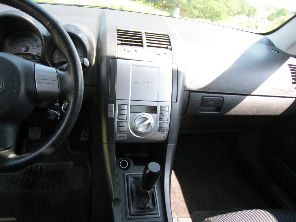

Any smooth paint surafce is gonna show every finger print and spec of dust. That's why interior surfaces are usually either textured, or a random color pattern (such as wood-grain). Flat paint is a lot better than glossy, but it is far more prone to fading, scratching, and chipping since it doesn't have any clear coat. Even the stock silver pieces in the tC are really bad about scuffs and scratches.
I used Rustoleum Textured Mettalic (from Autozone) on mine, without any clearcoat, or sealer, or anything. It never looks dirty, it doesn't show fingerprints at all, and it never produces any glare in the sun. It matches the stock (unpainted) dash pieces fairly well, and it ties in nicely with my BSP exterior and the faux-carbon fiber look of the seat fabric. I've had mine painted since spring, and it's not showing any signs of fading in the sun, and it doesn't have any chips or blemishes, so it's holding up pretty well too.
In the picture below it's hard to see it all in the direct sun, but the upper section is painted (all except the vents and *****). You can see the mettalic flake in the sunlight though, and you can see how the color compares to the non-painted pieces. The guage bezel is also painted.
