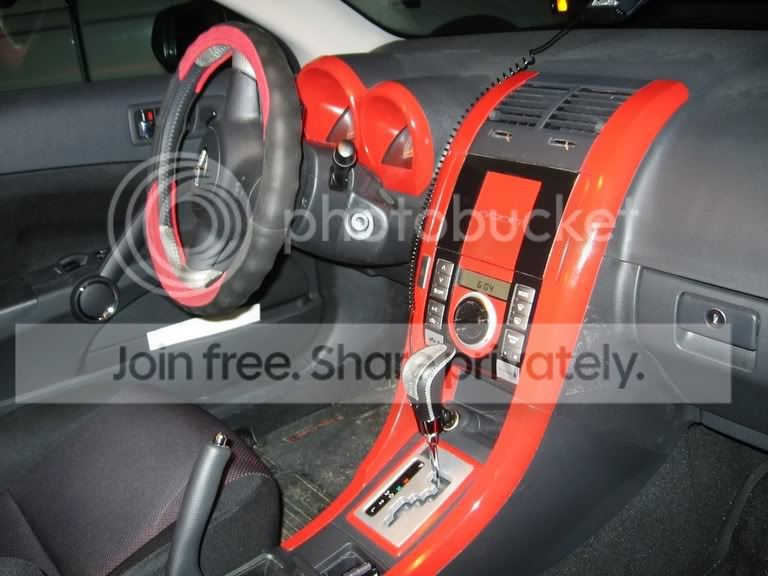

i painted these
mine
koolaid's

Hey PHXLOCO, what king of paint did you use for the interior?

automotive exterior paint!
same as the car.
just sand with a scotch brite pad, nothing to rough.
primer(automotive)
base coat(automotive)
clear coat(automotive)
