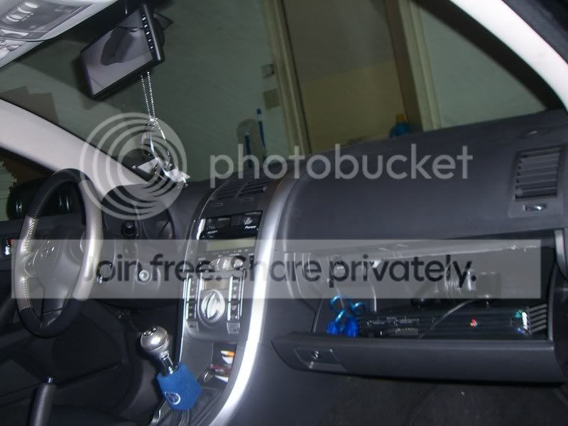

i found a inverter at auto zone that has 400 watts and can run 24 amps for 50 bucks, i havn't bought it just yet cuz i don't have the money, so right now i just have a ps2 in my glove box.
the screen is in my rear view mirror.
